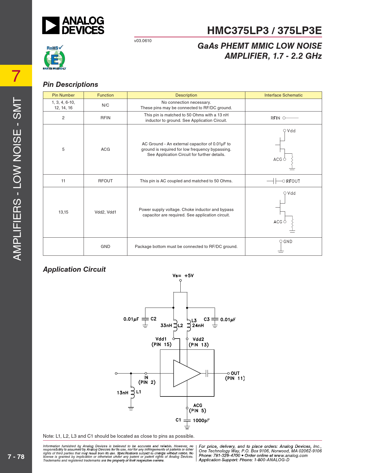

Pin Descriptions
Pin Number Function Description Interface Schematic T 1, 3, 4, 6-10, No connection necessary. N/C 12, 14, 16 These pins may be connected to RF/DC ground. This pin is matched to 50 Ohms with a 13 nH 2 RFIN inductor to ground. See Application Circuit. E - SM IS AC Ground - An external capacitor of 0.01μF to 5 ACG ground is required for low frequency bypassing. See Application Circuit for further details. W NO O 11 RFOUT This pin is AC coupled and matched to 50 Ohms. - L S R Power supply voltage. Choke inductor and bypass 13,15 Vdd2, Vdd1 capacitor are required. See application circuit. IE IF L P M GND Package bottom must be connected to RF/DC ground. A
Application Circuit
Note: L1, L2, L3 and C1 should be located as close to pins as possible. Info F rmoatr pr ion f iurcne, de ished b ly iv A e n r al y o a g D n evd to p ices is bla eli c eve o ed t rde o be ras: H ccuratite tiatne M d reli iacr ble ow . Ho av wev e C er, n o o rpo Fora r t p iro ic n e ,, 2 d 0 eli A ve lrpha R y, and toad, C o place hoel rd m er s s fo : Ard, MA 01 nalog Devic 8 e 2 s 4 , Inc., responsibility is assumed by Analog Devices for its use, nor for any infringements of patents or other One Technology Way, P.O. Box 9106, Norwood, MA 02062-9106 Phone: 978-250-3343 Fax: 978-250-3373 O rights of third parties that may result from its use. Specifications subject to change without notice. No P rde hone r O : 7 n 81- -3li 2n 9 e a -47 t w 0 w 0 • O w rd .ehit r o t nilte in .c e ao t m
