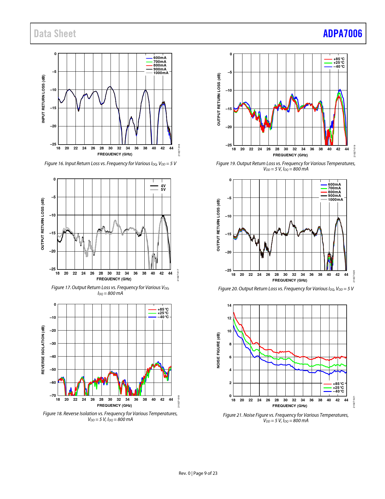

Data Sheet. ADPA7006. 600mA. +85°C. 700mA. +25°C. 800mA. –40°C. 900mA. 1000mA. –10. URN L. –15. UT P. INP. –20. –25. FREQUENCY (GHz). 700mA 800mA. S S. URN L T
Data Sheet ADPA7006 600mA +85°C 700mA +25°C 800mA –40°C 900mA 1000mA –10 URN L –15 UT P INP –20 –25 FREQUENCY (GHz) 700mA 800mA S S URN L T
Data Sheet ADPA7006 0 0 600mA +85°C 700mA +25°C 800mA –40°C 900mA –5 1000mA –5 B) B) d d ( ( S S S S O –10 O –10 URN L URN L T T –15 RE RE –15 UT UT P INP UT –20 O –20 –25 –25 18 20 22 24 26 28 30 32 34 36 38 40 42 44

21027- Figure 16. Input Return Loss vs. Frequency for Various IDQ, VDD = 5 V Figure 19. Output Return Loss vs. Frequency for Various Temperatures, VDD = 5 V, IDQ = 800 mA

21027- Figure 17. Output Return Loss vs. Frequency for Various VDD, Figure 20. Output Return Loss vs. Frequency for Various IDQ, VDD = 5 V IDQ = 800 mA
0 14 +85°C +25°C –10 –40°C 12 ) B –20 (d ) 10 N dB IO ( T E A –30 R 8 L SO –40 FIGU E 6 SE I OIS N EVER –50 4 R –60 2 +85°C +25°C –40°C –70 0 18 20 22 24 26 28 30 32 34 36 38 40 42 44

21027- Figure 18. Reverse Isolation vs. Frequency for Various Temperatures, Figure 21. Noise Figure vs. Frequency for Various Temperatures, VDD = 5 V, IDQ = 800 mA VDD = 5 V, IDQ = 800 mA Rev. 0 | Page 9 of 23 Document Outline FEATURES APPLICATIONS FUNCTIONAL BLOCK DIAGRAM GENERAL DESCRIPTION TABLE OF CONTENTS REVISION HISTORY SPECIFICATIONS 18 GHz TO 24 GHz FREQUENCY RANGE 20 GHz TO 24 GHz FREQUENCY RANGE 24 GHz TO 34 GHz FREQUENCY RANGE 34 GHz TO 44 GHz FREQUENCY RANGE ABSOLUTE MAXIMUM RATINGS THERMAL RESISTANCE ESD CAUTION PIN CONFIGURATION AND FUNCTION DESCRIPTIONS INTERFACE SCHEMATICS TYPICAL PERFORMANCE CHARACTERISTICS CONSTANT IDD OPERATION THEORY OF OPERATION APPLICATIONS INFORMATION BIASING PROCEDURES BIASING THE ADPA7006 WITH THE HMC980LP4E APPLICATION CIRCUIT SETUP LIMITING VGATE AND VNEG TO MEET ADPA7006 VGG1 ABSOLUTE MAXIMUM RATINGS REQUIREMENT HMC980LP4E BIAS SEQUENCE CONSTANT DRAIN CURRENT BIASING vs. CONSTANT GATE VOLTAGE BIASING OUTLINE DIMENSIONS ORDERING GUIDE
