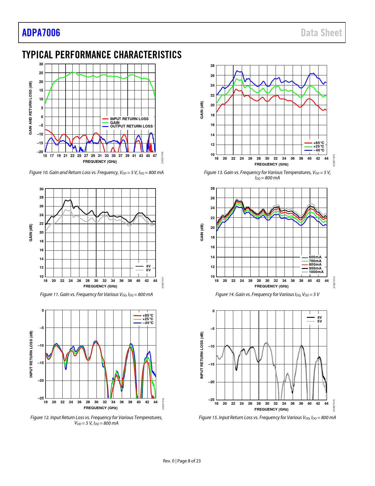

ADPA7006. Data Sheet. TYPICAL PERFORMANCE CHARACTERISTICS. B) d. ( S. S O. URN L. N ( AI. INPUT RETURN LOSS. GAIN. N AND RE
ADPA7006 Data Sheet TYPICAL PERFORMANCE CHARACTERISTICS B) d ( S S O URN L N ( AI INPUT RETURN LOSS GAIN N AND RE
ADPA7006 Data Sheet TYPICAL PERFORMANCE CHARACTERISTICS 30 28 25 26 20 B) d 24 ( S 15 S O 22 10 B) 20 URN L d T 5 N ( AI 18 0 INPUT RETURN LOSS G GAIN 16 N AND RE –5 OUTPUT RETURN LOSS AI G –10 14 –15 +85°C 12 +25°C –20 –40°C 15 17 19 21 23 25 27 29 31 33 35 37 39 41 43 45 47

21027- Figure 10. Gain and Return Loss vs. Frequency, VDD = 5 V, IDQ = 800 mA Figure 13. Gain vs. Frequency for Various Temperatures, VDD = 5 V, IDQ = 800 mA
30 28 28 26 26 24 24 22 22 B) B) d d 20 N ( 20 N ( AI AI 18 G 18 G 16 16 14 14 600mA 700mA 800mA 12 4V 12 5V 900mA 1000mA 10

21027- Figure 11. Gain vs. Frequency for Various VDD, IDQ = 800 mA Figure 14. Gain vs. Frequency for Various IDQ, VDD = 5 V
0 0 +85°C +25°C 4V –40°C 5V –5 –5 B) d B) ( d S ( S S S O –10 O –10 URN L T URN L T –15 RE –15 RE UT UT INP INP –20 –20 –25 –25 18 20 22 24 26 28 30 32 34 36 38 40 42 44

21027- Figure 12. Input Return Loss vs. Frequency for Various Temperatures, Figure 15. Input Return Loss vs. Frequency for Various VDD, IDQ = 800 mA VDD = 5 V, IDQ = 800 mA Rev. 0 | Page 8 of 23 Document Outline FEATURES APPLICATIONS FUNCTIONAL BLOCK DIAGRAM GENERAL DESCRIPTION TABLE OF CONTENTS REVISION HISTORY SPECIFICATIONS 18 GHz TO 24 GHz FREQUENCY RANGE 20 GHz TO 24 GHz FREQUENCY RANGE 24 GHz TO 34 GHz FREQUENCY RANGE 34 GHz TO 44 GHz FREQUENCY RANGE ABSOLUTE MAXIMUM RATINGS THERMAL RESISTANCE ESD CAUTION PIN CONFIGURATION AND FUNCTION DESCRIPTIONS INTERFACE SCHEMATICS TYPICAL PERFORMANCE CHARACTERISTICS CONSTANT IDD OPERATION THEORY OF OPERATION APPLICATIONS INFORMATION BIASING PROCEDURES BIASING THE ADPA7006 WITH THE HMC980LP4E APPLICATION CIRCUIT SETUP LIMITING VGATE AND VNEG TO MEET ADPA7006 VGG1 ABSOLUTE MAXIMUM RATINGS REQUIREMENT HMC980LP4E BIAS SEQUENCE CONSTANT DRAIN CURRENT BIASING vs. CONSTANT GATE VOLTAGE BIASING OUTLINE DIMENSIONS ORDERING GUIDE
