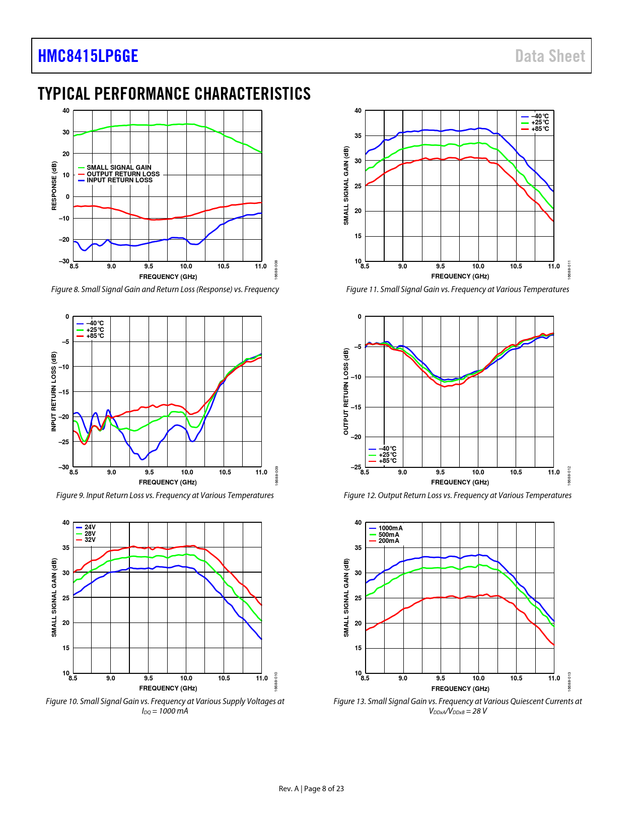

HMC8415LP6GE. Data Sheet. TYPICAL PERFORMANCE CHARACTERISTICS. –40°C +25°C +85°C. N (. SMALL SIGNAL GAIN. OUTPUT RETURN LOSS. SE (d
HMC8415LP6GE Data Sheet TYPICAL PERFORMANCE CHARACTERISTICS –40°C +25°C +85°C N ( SMALL SIGNAL GAIN OUTPUT RETURN LOSS SE (d
HMC8415LP6GE Data Sheet TYPICAL PERFORMANCE CHARACTERISTICS 40 40 –40°C +25°C +85°C 30 35 B) 20 d ) 30 B N ( SMALL SIGNAL GAIN AI 10 OUTPUT RETURN LOSS G SE (d INPUT RETURN LOSS L N A 25 0 IGN ESPO S L R L 20 –10 SMA 15 –20 –30 10

16688- Figure 8. Small Signal Gain and Return Loss (Response) vs. Frequency Figure 11. Small Signal Gain vs. Frequency at Various Temperatures
0 0 –40°C +25°C +85°C –5 –5 B) B) d d ( ( S S –10 S S O O –10 –15 URN L URN L T T RE –15 RE –20 UT UT P INP UT O –20 –25 –40°C +25°C +85°C –30 –25 8.5 9.0 9.5 10.0 10.5 11.0

16688- Figure 9. Input Return Loss vs. Frequency at Various Temperatures Figure 12. Output Return Loss vs. Frequency at Various Temperatures
40 40 24V 1000mA 28V 500mA 32V 200mA 35 35 B) B) d d 30 N ( 30 N ( AI AI G G L L A 25 A 25 IGN IGN S S L L L 20 L 20 SMA SMA 15 15 10 10 8.5 9.0 9.5 10.0 10.5 11.0

16688- Figure 10. Small Signal Gain vs. Frequency at Various Supply Voltages at Figure 13. Small Signal Gain vs. Frequency at Various Quiescent Currents at IDQ = 1000 mA VDDxA/VDDxB = 28 V Rev. A | Page 8 of 23 Document Outline FEATURES APPLICATIONS FUNCTIONAL BLOCK DIAGRAM GENERAL DESCRIPTION REVISION HISTORY SPECIFICATIONS ELECTRICAL SPECIFICATIONS TOTAL TARGET QUIESCENT CURRENT BY VDDxA/VDDxB ABSOLUTE MAXIMUM RATINGS THERMAL RESISTANCE ESD CAUTION PIN CONFIGURATION AND FUNCTION DESCRIPTIONS INTERFACE SCHEMATICS TYPICAL PERFORMANCE CHARACTERISTICS THEORY OF OPERATION APPLICATIONS INFORMATION TYPICAL APPLICATION CIRCUIT AND PULSOR CIRCUIT USING THE EV1HMC8415LP6G WITH THE DRAIN BIAS PULS0R BOARD RECOMMENDED BIAS SEQUENCE Power-Up Bias Concept for the EV1HMC8415LP6G with the Pulsor Power-Down Bias Concept for the EV1HMC8415LP6G with the Pulsor MAKING AVERAGE TO PULSED APPROXIMATIONS EVALUATION PCB BILL OF MATERIALS OUTLINE DIMENSIONS ORDERING GUIDE
