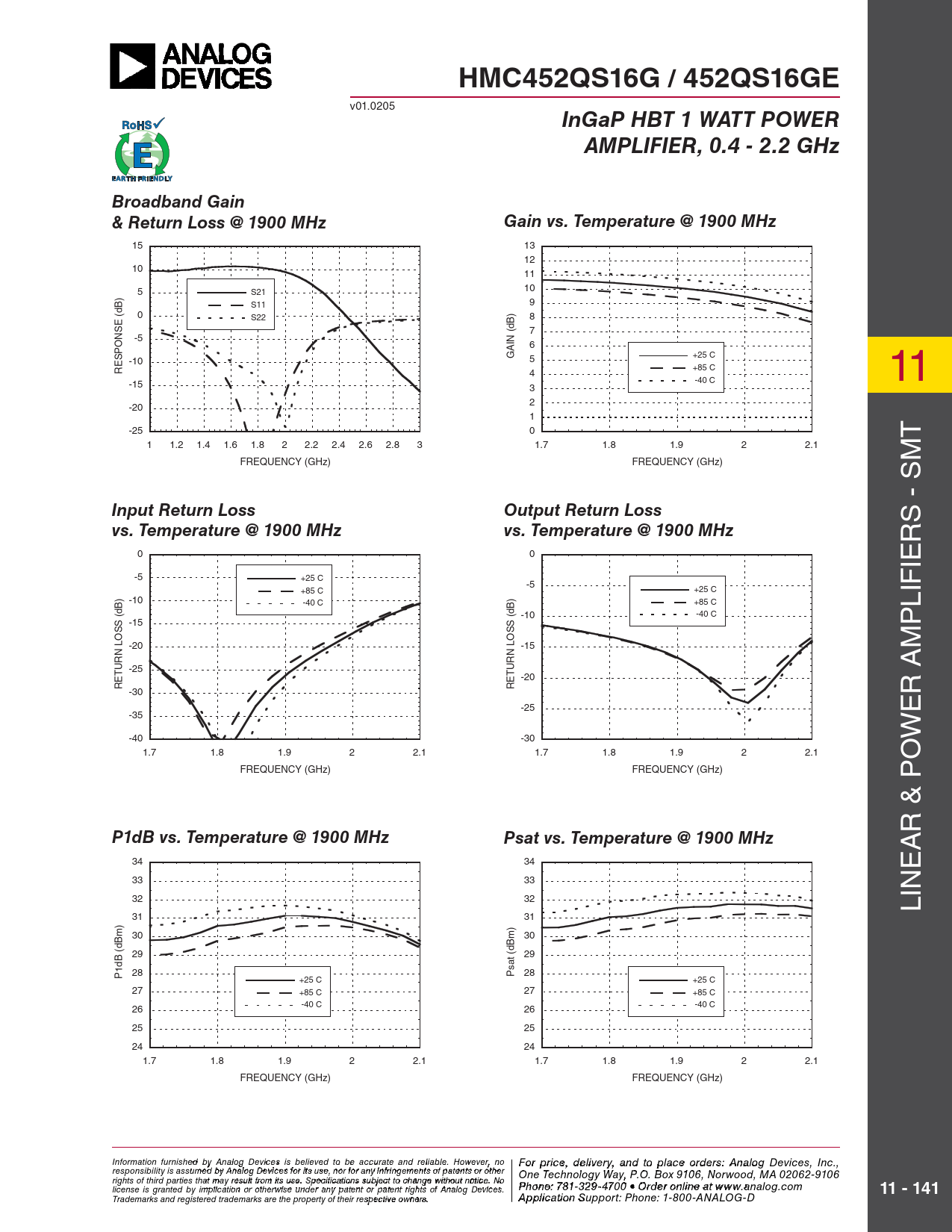

HMC452QS16G / 452QS16GE. InGaP HBT 1 WATT POWER. AMPLIFIER, 0.4 - 2.2 GHz. Broadband Gain & Return Loss @ 1900 MHz
HMC452QS16G / 452QS16GE InGaP HBT 1 WATT POWER AMPLIFIER, 0.4 - 2.2 GHz Broadband Gain & Return Loss @ 1900 MHz
v01.0205
InGaP HBT 1 WATT POWER AMPLIFIER, 0.4 - 2.2 GHz Broadband Gain & Return Loss @ 1900 MHz Gain vs. Temperature @ 1900 MHz
15 13 12 10 11 5 10 S21 S11 9 0 S22 8 (dB) 7 -5 6 GAIN +25 C -10 5 RESPONSE (dB) +85 C 4 -15 -40 C 3 11 2 -20 1 -25 0 T 1 1.2 1.4 1.6 1.8 2 2.2 2.4 2.6 2.8 3 1.7 1.8 1.9 2 2.1 FREQUENCY (GHz) FREQUENCY (GHz) - SM
Input Return Loss Output Return Loss
S
vs. Temperature @ 1900 MHz vs. Temperature @ 1900 MHz
0 0 -5 +25 C -5 +85 C +25 C -10 -40 C +85 C -10 -40 C -15 PLIFIER -20 -15 M -25 -20 RETURN LOSS (dB) RETURN LOSS (dB) -30 -25 -35 ER A -40 -30 W 1.7 1.8 1.9 2 2.1 1.7 1.8 1.9 2 2.1 O FREQUENCY (GHz) FREQUENCY (GHz) & P R
P1dB vs. Temperature @ 1900 MHz Psat vs. Temperature @ 1900 MHz
A 34 34 E 33 33 32 32 31 31 LIN 30 30 29 29 28 Psat (dBm) 28 P1dB (dBm) +25 C +25 C 27 +85 C 27 +85 C -40 C -40 C 26 26 25 25 24 24 1.7 1.8 1.9 2 2.1 1.7 1.8 1.9 2 2.1 FREQUENCY (GHz) FREQUENCY (GHz) Information furnish F e o d r pri by An ce, de alog Devic leis vie s rbyeli, a eve nd to pla d to be accur ce o ate an r d der relia s ble , pl . Ho ease co wever, no For price, delivery, and to place orders: Analog Devices, Inc., responsibility is assumed by Analog Devices for its use, nor for any infringements of patents or other ntact Hittite Microwave Corporation: One Technology Way, P.O. Box 9106, Norwood, MA 02062-9106 20 Alpha Road, Chelmsford, MA 01824 Phone rights of third parties that may result from its use. Specifications subject to change without notice. No license is granted by implication or otherwise under any patent or patent rights of Analog Devices. : 978 Pho - n 25 e: 7 0- 81 33 2 4 9- 3 F 470 ax: 978 0 • Order o - n 25 lin 0 e a-t 3373 www.analog.com
