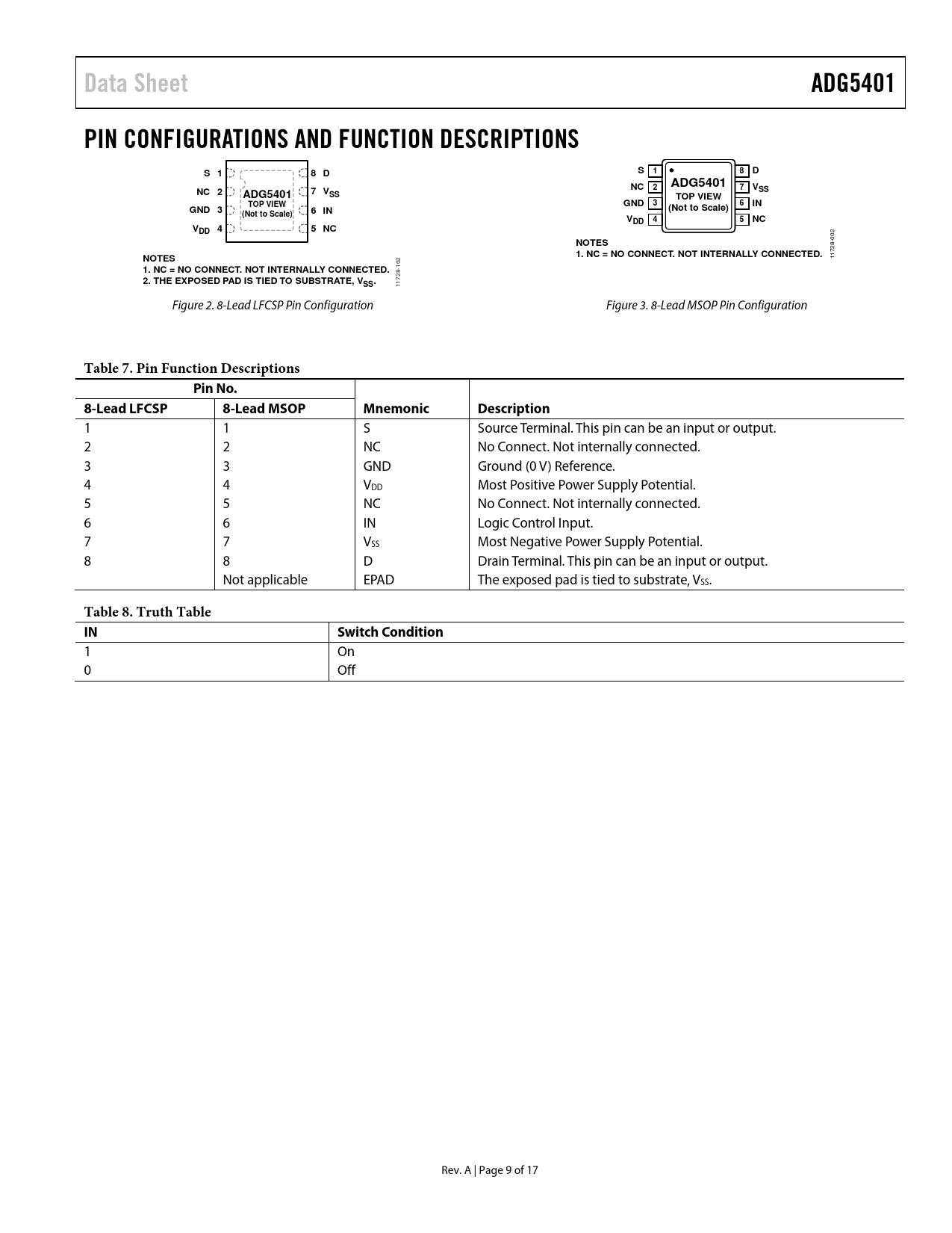

Data Sheet. ADG5401. PIN CONFIGURATIONS AND FUNCTION DESCRIPTIONS. S 1. 8 D. NC 2. 7 V. TOP VIEW. GND. GND 3. 6 IN. (Not to Scale). VDD 4. 5 NC
Data Sheet ADG5401 PIN CONFIGURATIONS AND FUNCTION DESCRIPTIONS S 1 8 D NC 2 7 V TOP VIEW GND GND 3 6 IN (Not to Scale) VDD 4 5 NC
Data Sheet ADG5401 PIN CONFIGURATIONS AND FUNCTION DESCRIPTIONS S 1 8 D S 1 8 D NC ADG5401 2 7 V NC 2 7 V SS ADG5401 SS TOP VIEW TOP VIEW GND 3 6 IN GND 3 6 IN (Not to Scale) (Not to Scale) VDD 4 5 NC V 4 DD 5 NC
002
NOTES 1. NC = NO CONNECT. NOT INTERNALLY CONNECTED.
1728-
NOTES
1 102
1. NC = NO CONNECT. NOT INTERNALLY CONNECTED. 2. THE EXPOSED PAD IS TIED TO SUBSTRATE, V
1728-
SS.
1 Figure 2. 8-Lead LFCSP Pin Configuration Figure 3. 8-Lead MSOP Pin Configuration
Table 7. Pin Function Descriptions Pin No. 8-Lead LFCSP 8-Lead MSOP Mnemonic Description
1 1 S Source Terminal. This pin can be an input or output. 2 2 NC No Connect. Not internally connected. 3 3 GND Ground (0 V) Reference. 4 4 VDD Most Positive Power Supply Potential. 5 5 NC No Connect. Not internally connected. 6 6 IN Logic Control Input. 7 7 VSS Most Negative Power Supply Potential. 8 8 D Drain Terminal. This pin can be an input or output. Not applicable EPAD The exposed pad is tied to substrate, VSS.
Table 8. Truth Table IN Switch Condition
1 On 0 Off Rev. A | Page 9 of 17 Document Outline FEATURES APPLICATIONS FUNCTIONAL BLOCK DIAGRAM GENERAL DESCRIPTION PRODUCT HIGHLIGHTS TABLE OF CONTENTS REVISION HISTORY SPECIFICATIONS ±15 V DUAL SUPPLY ±20 V DUAL SUPPLY 12 V SINGLE SUPPLY 36 V SINGLE SUPPLY CONTINUOUS CURRENT PER CHANNEL, S OR D ABSOLUTE MAXIMUM RATINGS ESD CAUTION PIN CONFIGURATIONS AND FUNCTION DESCRIPTIONS TYPICAL PERFORMANCE CHARACTERISTICS TEST CIRCUITS TERMINOLOGY APPLICATIONS INFORMATION TRENCH ISOLATION OUTLINE DIMENSIONS ORDERING GUIDE
