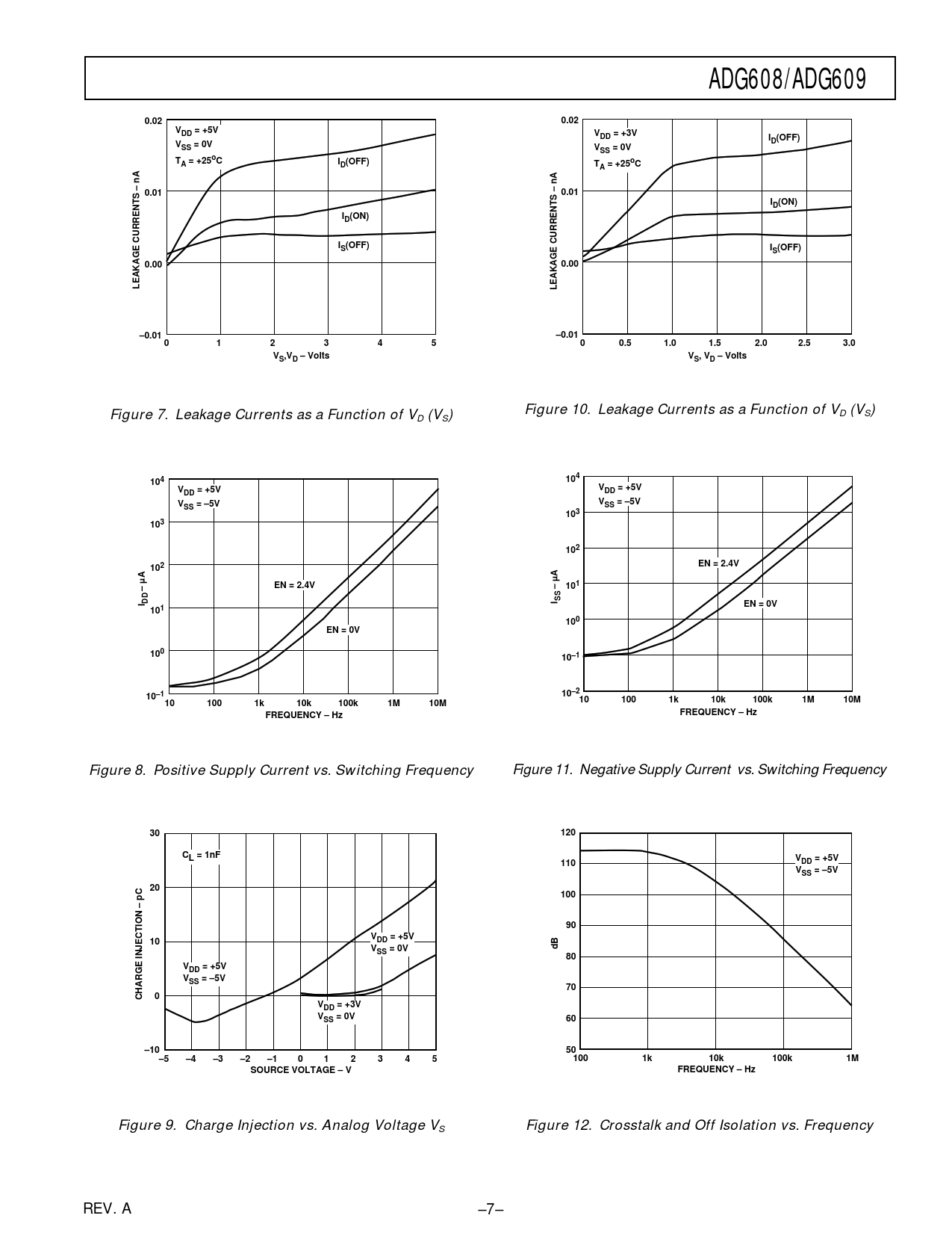

ADG608/ADG609. 0.02. VDD = +5V. VDD = +3V. D(OFF). SS = 0V. VSS = 0V. TA = +25oC. ID(OFF). 0.01. ID(ON). IS(OFF). 0.00. LEAKAGE CURRENTS – nA
ADG608/ADG609 0.02 VDD = +5V VDD = +3V D(OFF) SS = 0V VSS = 0V TA = +25oC ID(OFF) 0.01 ID(ON) IS(OFF) 0.00 LEAKAGE CURRENTS – nA
ADG608/ADG609 0.02 0.02 VDD = +5V VDD = +3V I V D(OFF) SS = 0V VSS = 0V TA = +25oC ID(OFF) TA = +25oC 0.01 0.01 ID(ON) ID(ON) IS(OFF) IS(OFF) 0.00 0.00 LEAKAGE CURRENTS – nA LEAKAGE CURRENTS – nA –0.01 –0.01 0 1 2 3 4 5 0 0.5 1.0 1.5 2.0 2.5 3.0 VS,VD – Volts VS, VD – Volts
Figure 7. Leakage Currents as a Function of V Figure 10. Leakage Currents as a Function of VD (VS) D (VS)
104 104 V V DD = +5V DD = +5V V V SS = –5V SS = –5V 103 103 102 EN = 2.4V 102 EN = 2.4V – µA – µA 101 I DD I SS EN = 0V 101 100 EN = 0V 100 10–1 10–1 10–2 10 100 1k 10k 100k 1M 10M 10 100 1k 10k 100k 1M 10M FREQUENCY – Hz FREQUENCY – Hz
Figure 8. Positive Supply Current vs. Switching Frequency Figure 11. Negative Supply Current vs. Switching Frequency
30 120 CL = 1nF V 110 DD = +5V VSS = –5V 20 100 90 V 10 DD = +5V V dB SS = 0V 80 VDD = +5V VSS = –5V 70 CHARGE INJECTION – pC 0 VDD = +3V VSS = 0V 60 –10 50 –5 –4 –3 –2 –1 0 1 2 3 4 5 100 1k 10k 100k 1M SOURCE VOLTAGE – V FREQUENCY – Hz
Figure 9. Charge Injection vs. Analog Voltage VS Figure 12. Crosstalk and Off Isolation vs. Frequency REV. A –7–
