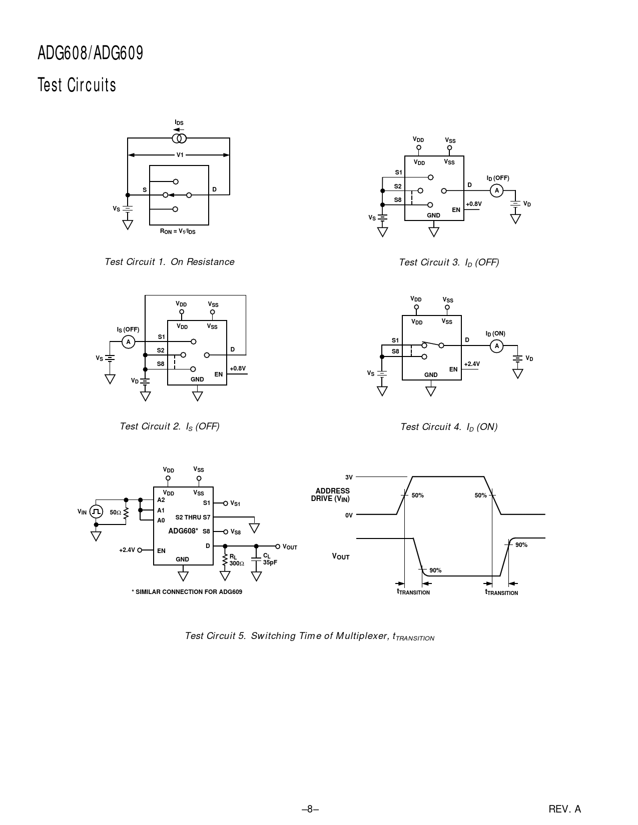

ADG608/ADG609. Test Circuits. IDS. VDD. VSS. ID (OFF). +0.8V. GND. RON = V1/IDS. S (OFF). ID (ON). +2.4V. ADDRESS. 50%. DRIVE (VIN). VS1. VIN. S2 THRU S7
ADG608/ADG609 Test Circuits IDS VDD VSS ID (OFF) +0.8V GND RON = V1/IDS S (OFF) ID (ON) +2.4V ADDRESS 50% DRIVE (VIN) VS1 VIN S2 THRU S7
ADG608/ADG609 Test Circuits IDS VDD VSS V1 V V DD SS S1 ID (OFF) S2 D S D A S8 +0.8V VD VS EN V GND S RON = V1/IDS
Test Circuit 1. On Resistance Test Circuit 3. ID (OFF)
VDD VSS VDD VSS V V DD SS V V I DD SS S (OFF) ID (ON) S1 S1 D A A S2 D S8 VS VD S8 +2.4V +0.8V EN V EN S GND VD GND
Test Circuit 2. IS (OFF) Test Circuit 4. ID (ON)
V V DD SS 3V V V ADDRESS DD SS 50% 50% A2 DRIVE (VIN) S1 VS1 A1 VIN 50
S2 THRU S7 0V A0 ADG608* S8 VS8 D 90% VOUT +2.4V EN RL CL VOUT GND 300
35pF 90% * SIMILAR CONNECTION FOR ADG609 tTRANSITION tTRANSITION
Test Circuit 5. Switching Time of Multiplexer, tTRANSITION –8– REV. A
