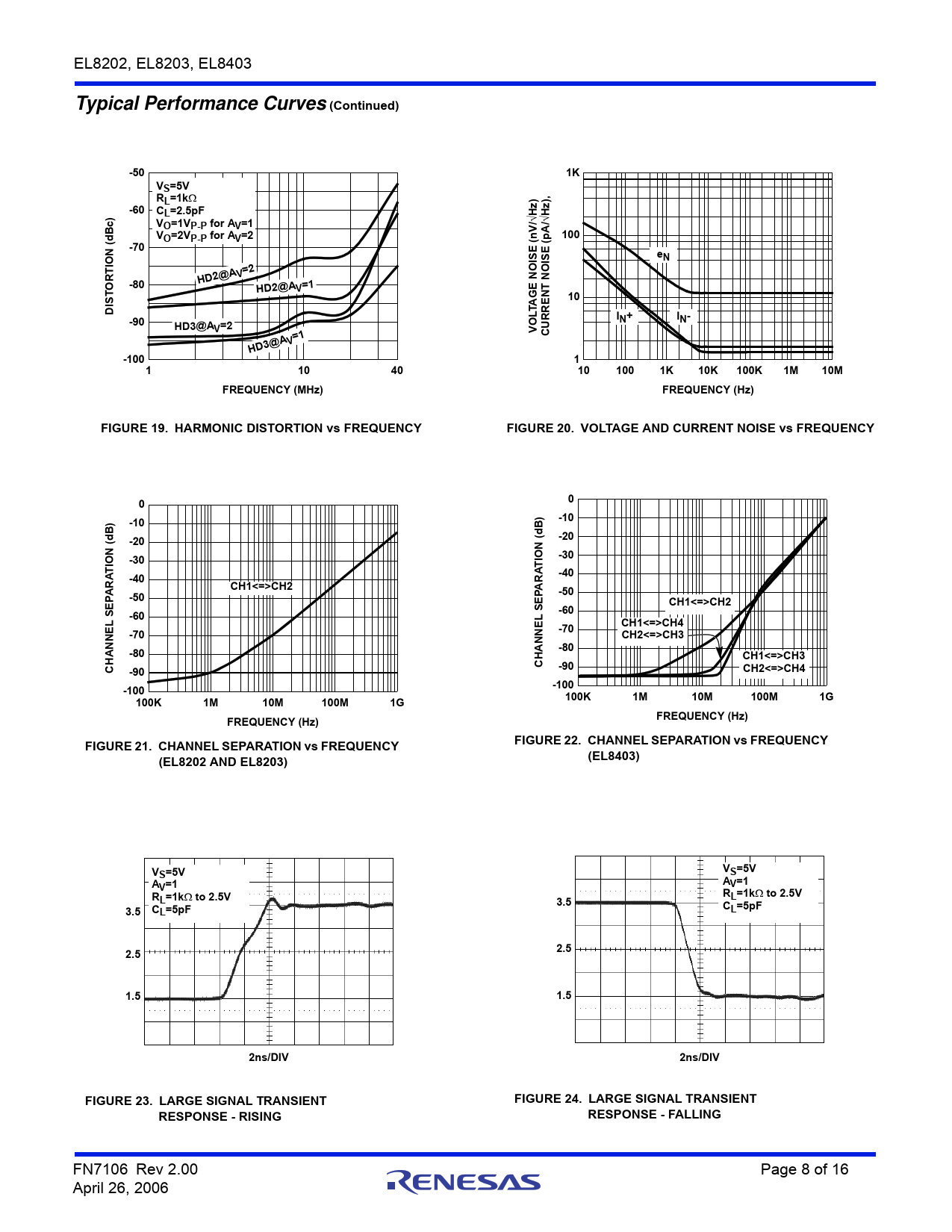

Pages / Page16 / 8 — Typical Performance Curves. (Continued). -50. VS=5V. RL=1k. -60 CL=2.5pF. …
Typical Performance Curves. (Continued). -50. VS=5V. RL=1k. -60 CL=2.5pF. Hz). Hz),. O=1VP-P for AV=1. 100. (dBc). O=2VP-P for AV=2. (nV/. -70
Typical Performance Curves (Continued) -50 VS=5V RL=1k -60 CL=2.5pF Hz) Hz), O=1VP-P for AV=1 100 (dBc) O=2VP-P for AV=2 (nV/ -70
EL8202, EL8203, EL8403
Typical Performance Curves (Continued) -50 1K VS=5V RL=1k -60 CL=2.5pF V
Hz)
Hz), O=1VP-P for AV=1 V 100 (dBc) O=2VP-P for AV=2 (nV/ -70 (pA/ N E SE eN TIO OIS R HD2@AV=2 NOI O -80 HD2@AV=1 10 DIST LTAGE -90 IN+ IN- HD3@AV=2 VO CURRENT N HD3@AV=1 -100 1 1 10 40 10 100 1K 10K 100K 1M 10M FREQUENCY (MHz) FREQUENCY (Hz) FIGURE 19. HARMONIC DISTORTION vs FREQUENCY FIGURE 20. VOLTAGE AND CURRENT NOISE vs FREQUENCY 0 0 -10 -10 -20 -20 -30 -30 TION (dB) TION (dB) -40 -40 RA ARA CH1<=>CH2 A -50 P -50 CH1<=>CH2 -60 SE -60 L CH1<=>CH4 -70 -70 NNE CH2<=>CH3 -80 -80 CH1<=>CH3 CHANNEL SEP CHA -90 -90 CH2<=>CH4 -100 -100 100K 1M 10M 100M 1G 100K 1M 10M 100M 1G FREQUENCY (Hz) FREQUENCY (Hz) FIGURE 21. CHANNEL SEPARATION vs FREQUENCY FIGURE 22. CHANNEL SEPARATION vs FREQUENCY (EL8202 AND EL8203) (EL8403) V V S=5V S=5V A A V=1 V=1 R R L=1k to 2.5V 3.5 L=1k to 2.5V C 3.5 CL=5pF L=5pF 2.5 2.5 1.5 1.5 2ns/DIV 2ns/DIV FIGURE 23. LARGE SIGNAL TRANSIENT FIGURE 24. LARGE SIGNAL TRANSIENT RESPONSE - RISING RESPONSE - FALLING
