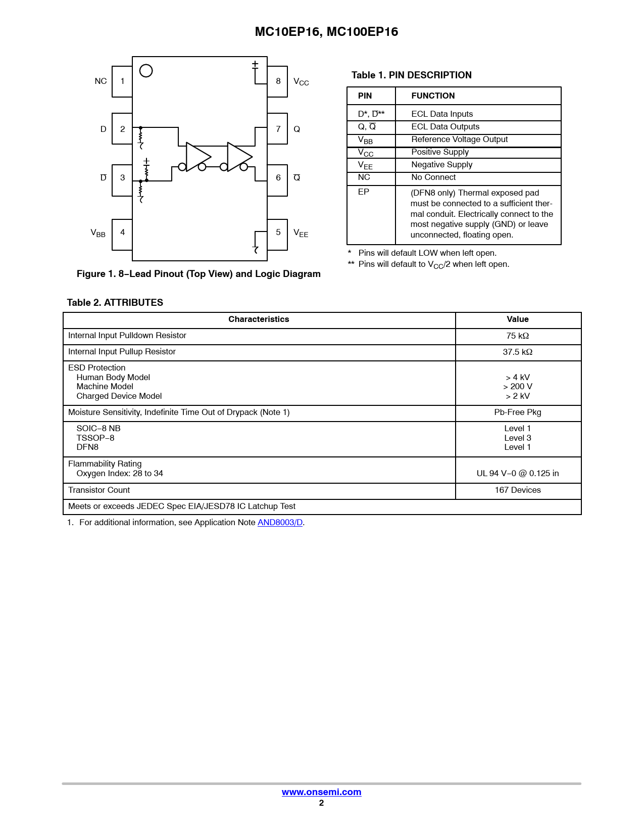

MC10EP16, MC100EP16. Table 1. PIN DESCRIPTION. PIN. FUNCTION. Figure 1. 8−Lead Pinout. (Top View) and Logic Diagram
MC10EP16, MC100EP16 Table 1 PIN DESCRIPTION PIN FUNCTION Figure 1 8−Lead Pinout (Top View) and Logic Diagram
link to page 2
MC10EP16, MC100EP16 Table 1. PIN DESCRIPTION
NC 1 8 VCC
PIN FUNCTION
D*, D** ECL Data Inputs D 2 7 Q Q, Q ECL Data Outputs VBB Reference Voltage Output VCC Positive Supply VEE Negative Supply D 3 6 Q NC No Connect EP (DFN8 only) Thermal exposed pad must be connected to a sufficient ther- mal conduit. Electrically connect to the most negative supply (GND) or leave VBB 4 5 VEE unconnected, floating open. * Pins will default LOW when left open. ** Pins will default to VCC/2 when left open.
Figure 1. 8−Lead Pinout (Top View) and Logic Diagram Table 2. ATTRIBUTES Characteristics Value
Internal Input Pulldown Resistor 75 kW Internal Input Pullup Resistor 37.5 kW ESD Protection Human Body Model > 4 kV Machine Model > 200 V Charged Device Model > 2 kV Moisture Sensitivity, Indefinite Time Out of Drypack (Note 1) Pb-Free Pkg SOIC−8 NB Level 1 TSSOP−8 Level 3 DFN8 Level 1 Flammability Rating Oxygen Index: 28 to 34 UL 94 V−0 @ 0.125 in Transistor Count 167 Devices Meets or exceeds JEDEC Spec EIA/JESD78 IC Latchup Test 1. For additional information, see Application Note AND8003/D.
