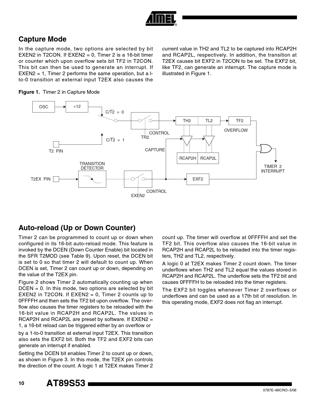

Capture Mode
In the capture mode, two options are selected by bit current value in TH2 and TL2 to be captured into RCAP2H EXEN2 in T2CON. If EXEN2 = 0, Timer 2 is a 16-bit timer and RCAP2L, respectively. In addition, the transition at or counter which upon overflow sets bit TF2 in T2CON. T2EX causes bit EXF2 in T2CON to be set. The EXF2 bit, This bit can then be used to generate an interrupt. If like TF2, can generate an interrupt. The capture mode is EXEN2 = 1, Timer 2 performs the same operation, but a l- illustrated in Figure 1. to-0 transition at external input T2EX also causes the
Figure 1.
Timer 2 in Capture Mode OSC ÷12 C/T2 = 0 TH2 TL2 TF2 OVERFLOW CONTROL TR2 C/T2 = 1 T2 PIN CAPTURE RCAP2H RCAP2L TRANSITION DETECTOR TIMER 2 INTERRUPT T2EX PIN EXF2 CONTROL EXEN2
Auto-reload (Up or Down Counter)
Timer 2 can be programmed to count up or down when count up. The timer will overflow at 0FFFFH and set the configured in its 16-bit auto-reload mode. This feature is TF2 bit. This overflow also causes the 16-bit value in invoked by the DCEN (Down Counter Enable) bit located in RCAP2H and RCAP2L to be reloaded into the timer regis- the SFR T2MOD (see Table 9). Upon reset, the DCEN bit ters, TH2 and TL2, respectively. is set to 0 so that timer 2 will default to count up. When A logic 0 at T2EX makes Timer 2 count down. The timer DCEN is set, Timer 2 can count up or down, depending on underflows when TH2 and TL2 equal the values stored in the value of the T2EX pin. RCAP2H and RCAP2L. The underflow sets the TF2 bit and Figure 2 shows Timer 2 automatically counting up when causes 0FFFFH to be reloaded into the timer registers. DCEN = 0. In this mode, two options are selected by bit The EXF2 bit toggles whenever Timer 2 overflows or EXEN2 in T2CON. If EXEN2 = 0, Timer 2 counts up to underflows and can be used as a 17th bit of resolution. In 0FFFFH and then sets the TF2 bit upon overflow. The over- this operating mode, EXF2 does not flag an interrupt. flow also causes the timer registers to be reloaded with the 16-bit value in RCAP2H and RCAP2L. The values in RCAP2H and RCAP2L are preset by software. If EXEN2 = 1, a 16-bit reload can be triggered either by an overflow or by a 1-to-0 transition at external input T2EX. This transition also sets the EXF2 bit. Both the TF2 and EXF2 bits can generate an interrupt if enabled. Setting the DCEN bit enables Timer 2 to count up or down, as shown in Figure 3. In this mode, the T2EX pin controls the direction of the count. A logic 1 at T2EX makes Timer 2
