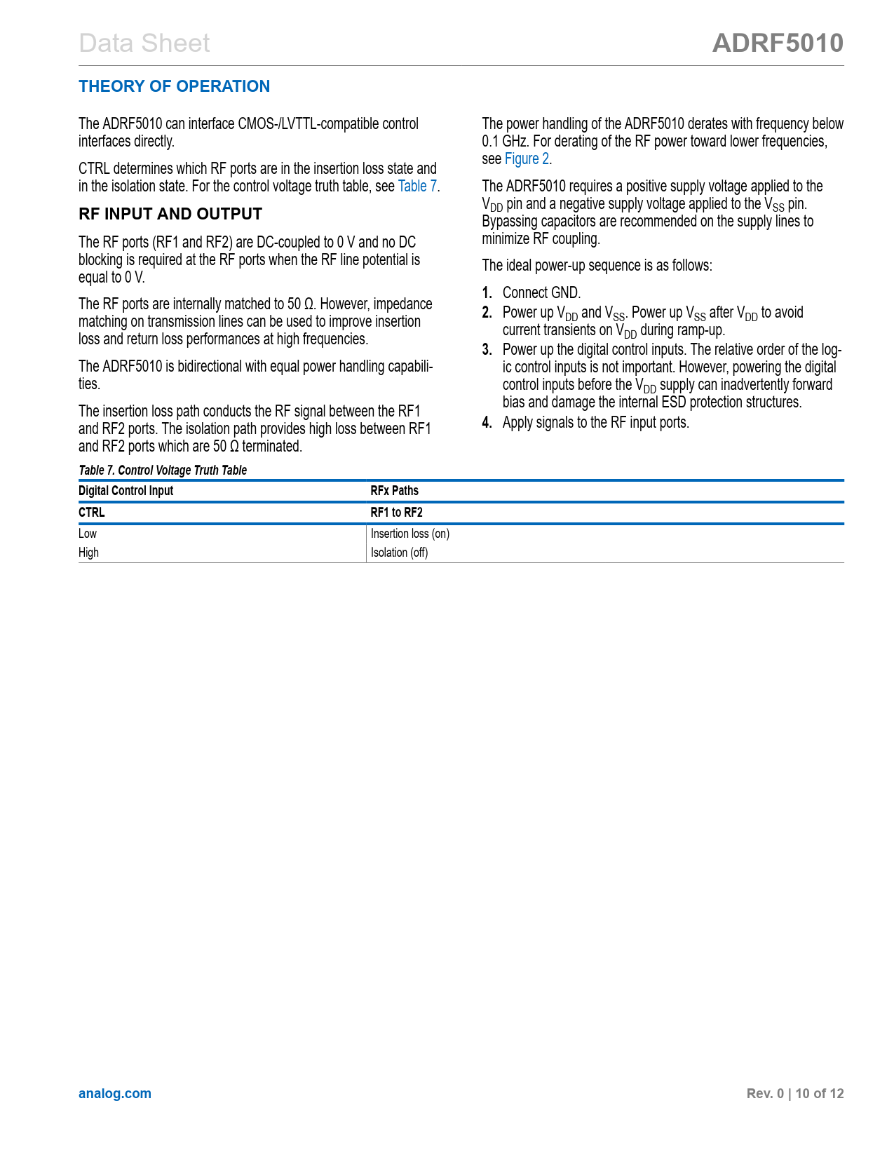

ADRF5010. THEORY OF OPERATION. RF INPUT AND OUTPUT. Table 7. Control Voltage Truth Table. Digital Control Input. RFx Paths. CTRL
ADRF5010 THEORY OF OPERATION RF INPUT AND OUTPUT Table 7 Control Voltage Truth Table Digital Control Input RFx Paths CTRL
link to page 10 link to page 5 Data Sheet
The ADRF5010 can interface CMOS-/LVTTL-compatible control The power handling of the ADRF5010 derates with frequency below interfaces directly. 0.1 GHz. For derating of the RF power toward lower frequencies, see Figure 2. CTRL determines which RF ports are in the insertion loss state and in the isolation state. For the control voltage truth table, see Table 7. The ADRF5010 requires a positive supply voltage applied to the V
RF INPUT AND OUTPUT
DD pin and a negative supply voltage applied to the VSS pin. Bypassing capacitors are recommended on the supply lines to The RF ports (RF1 and RF2) are DC-coupled to 0 V and no DC minimize RF coupling. blocking is required at the RF ports when the RF line potential is The ideal power-up sequence is as follows: equal to 0 V.
1.
Connect GND. The RF ports are internally matched to 50 Ω. However, impedance
2.
Power up V matching on transmission lines can be used to improve insertion DD and VSS. Power up VSS after VDD to avoid current transients on V loss and return loss performances at high frequencies. DD during ramp-up.
3.
Power up the digital control inputs. The relative order of the log- The ADRF5010 is bidirectional with equal power handling capabili- ic control inputs is not important. However, powering the digital ties. control inputs before the VDD supply can inadvertently forward The insertion loss path conducts the RF signal between the RF1 bias and damage the internal ESD protection structures. and RF2 ports. The isolation path provides high loss between RF1
4.
Apply signals to the RF input ports. and RF2 ports which are 50 Ω terminated.
Table 7. Control Voltage Truth Table Digital Control Input RFx Paths CTRL RF1 to RF2
Low Insertion loss (on) High Isolation (off)
