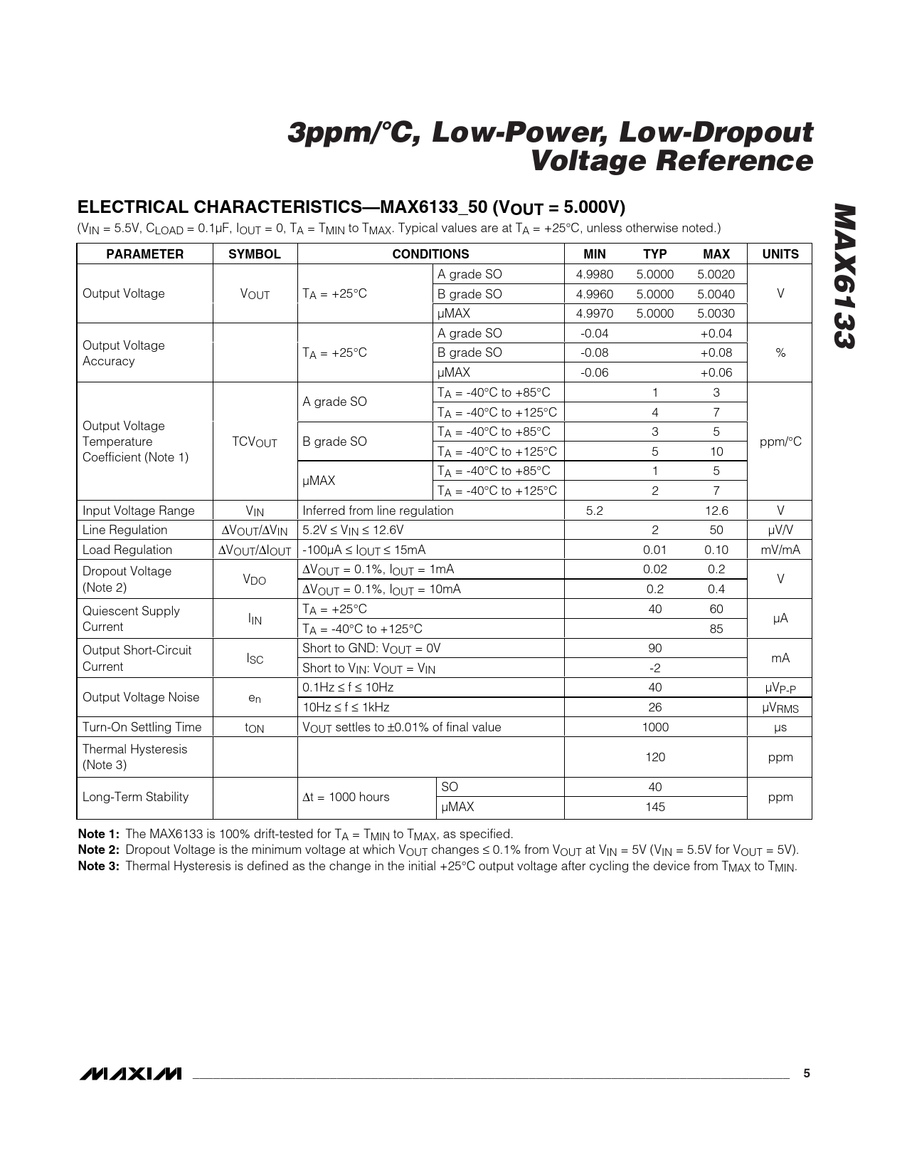

3ppm/°C, Low-Power, Low-Dropout. Voltage Reference. MAX6133. ELECTRICAL CHARACTERISTICS—MAX6133_50 (VOUT = 5.000V). PARAMETER
3ppm/°C, Low-Power, Low-Dropout Voltage Reference MAX6133 ELECTRICAL CHARACTERISTICS—MAX6133_50 (VOUT = 5.000V) PARAMETER
(VIN = 5.5V, CLOAD = 0.1µF, IOUT = 0, TA = TMIN to TMAX. Typical values are at TA = +25°C, unless otherwise noted.)
PARAMETER SYMBOL CONDITIONS MIN TYP MAX UNITS
A grade SO 4.9980 5.0000 5.0020 Output Voltage VOUT TA = +25°C B grade SO 4.9960 5.0000 5.0040 V µMAX 4.9970 5.0000 5.0030 A grade SO -0.04 +0.04 Output Voltage TA = +25°C B grade SO -0.08 +0.08 % Accuracy µMAX -0.06 +0.06 TA = -40°C to +85°C 1 3 A grade SO TA = -40°C to +125°C 4 7 Output Voltage TA = -40°C to +85°C 3 5 Temperature TCVOUT B grade SO ppm/°C TA = -40°C to +125°C 5 10 Coefficient (Note 1) TA = -40°C to +85°C 1 5 µMAX TA = -40°C to +125°C 2 7 Input Voltage Range VIN Inferred from line regulation 5.2 12.6 V Line Regulation ∆VOUT/∆VIN 5.2V ≤ VIN ≤ 12.6V 2 50 µV/V Load Regulation ∆VOUT/∆IOUT -100µA ≤ IOUT ≤ 15mA 0.01 0.10 mV/mA Dropout Voltage ∆VOUT = 0.1%, IOUT = 1mA 0.02 0.2 VDO V (Note 2) ∆VOUT = 0.1%, IOUT = 10mA 0.2 0.4 Quiescent Supply TA = +25°C 40 60 IIN µA Current TA = -40°C to +125°C 85 Output Short-Circuit Short to GND: VOUT = 0V 90 ISC mA Current Short to VIN: VOUT = VIN -2 0.1Hz ≤ f ≤ 10Hz 40 µVP-P Output Voltage Noise en 10Hz ≤ f ≤ 1kHz 26 µVRMS Turn-On Settling Time tON VOUT settles to ±0.01% of final value 1000 µs Thermal Hysteresis 120 ppm (Note 3) SO 40 Long-Term Stability ∆t = 1000 hours ppm µMAX 145
Note 1:
The MAX6133 is 100% drift-tested for TA = TMIN to TMAX, as specified.
Note 2:
Dropout Voltage is the minimum voltage at which VOUT changes ≤ 0.1% from VOUT at VIN = 5V (VIN = 5.5V for VOUT = 5V).
Note 3:
Thermal Hysteresis is defined as the change in the initial +25°C output voltage after cycling the device from TMAX to TMIN.
