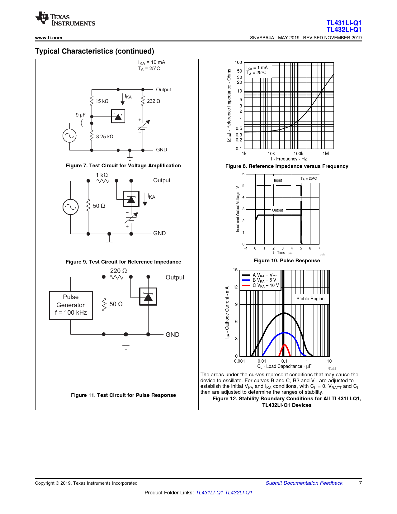

Pages / Page35 / 7 — TL431LI-Q1. TL432LI-Q1. www.ti.com. Typical Characteristics (continued). …
TL431LI-Q1. TL432LI-Q1. www.ti.com. Typical Characteristics (continued). Figure 7. Test Circuit for Voltage Amplification
TL431LI-Q1 TL432LI-Q1 www.ti.com Typical Characteristics (continued) Figure 7 Test Circuit for Voltage Amplification
SNVSBA4A – MAY 2019 – REVISED NOVEMBER 2019
I 100 KA = 10 mA T I A = 25°C 50 KA = 1 mA ms TA = 25°C Oh 30 - 20 e c Output an 10 I d KA 15 kΩ 232 Ω pe 5 Im 3 ce 2 9 µF ren + e 1 ef - R 0.5 − | A 0.3 8.25 kΩ K|Z 0.2 0.1 GND 1k 10k 100k 1M f - Frequency - Hz
Figure 7. Test Circuit for Voltage Amplification Figure 8. Reference Impedance versus Frequency
6 1 kΩ T Output Input A = 25qC 5 - V ge IKA 4 olta t V 50 Ω pu 3 Output − d Out 2 ut an + Inp 1 GND 0 -1 0 1 2 3 4 5 6 7 t - Time - Ps puls
Figure 9. Test Circuit for Reference Impedance Figure 10. Pulse Response
15 220 Ω A VKA = Vref Output B VKA = 5 V 12 C VKA = 10 V t - mA Pulse Stable Region en Generator 50 Ω 9 f = 100 kHz e Curr od 6 ath - C GND AIK 3 0 0.001 0.01 0.1 1 10 CL - Load Capacitance - µF C To Lpy 43 The areas under the curves represent conditions that may cause the device to oscillate. For curves B and C, R2 and V+ are adjusted to establish the initial VKA and IKA conditions, with CL = 0. VBATT and CL then are adjusted to determine the ranges of stability.
Figure 11. Test Circuit for Pulse Response Figure 12. Stability Boundary Conditions for All TL431LI-Q1, TL432LI-Q1 Devices
