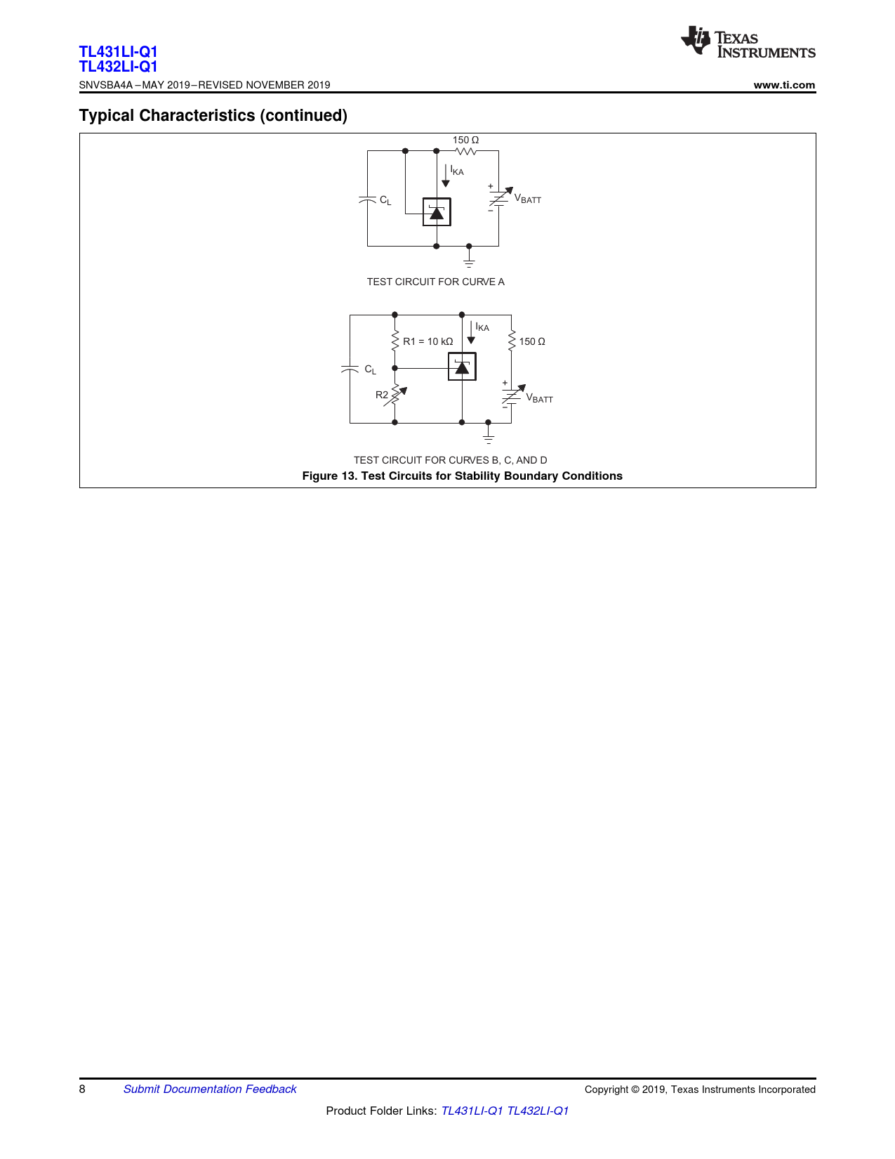

www.ti.com Typical Characteristics (continued)
150 Ω IKA + C V L BATT − TEST CIRCUIT FOR CURVE A IKA R1 = 10 kΩ 150 Ω CL + R2 VBATT − TEST CIRCUIT FOR CURVES B, C, AND D
Figure 13. Test Circuits for Stability Boundary Conditions
