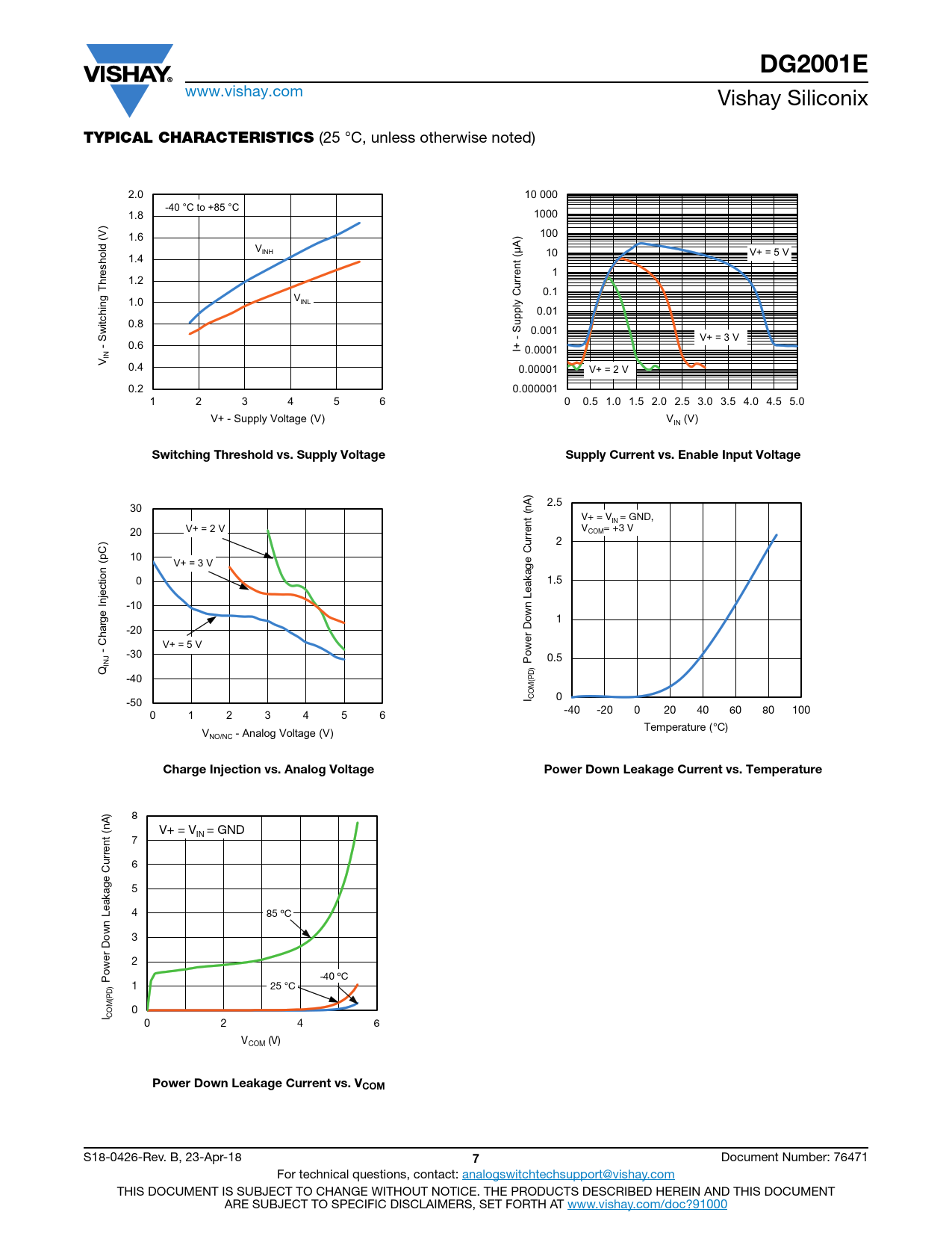

DG2001E. TYPICAL CHARACTERISTICS. Switching Threshold vs. Supply Voltage. Supply Current vs. Enable Input Voltage
DG2001E TYPICAL CHARACTERISTICS Switching Threshold vs Supply Voltage Supply Current vs Enable Input Voltage
DG2001E
(25 °C, unless otherwise noted) Axis Title Axis Title 2.0 10000 10 000 10000 -40 °C to +85 °C 1.8 1000 ) (V 1.6 100 d A) VINH (μ 10 V+ = 5 V 1.4 1000 1000 nt reshol 1 h 1.2 ne ne rre ne ine ne ine 0.1 V Cu ng T 1.0 INL 1st li 2nd li ly 1st li 2nd l 2nd l p 0.01 2nd li p itchi 0.8 100 u 100 w S 0.001 S - V+ = 3 V - 0.6 I+ 0.0001 INV 0.4 0.00001 V+ = 2 V 0.2 10 0.000001 10 1 2 3 4 5 6 0 0.5 1.0 1.5 2.0 2.5 3.0 3.5 4.0 4.5 5.0 V+ - Supply Voltage (V) V (V) IN 2nd line 2nd line
Switching Threshold vs. Supply Voltage Supply Current vs. Enable Input Voltage
Axis Title ) 2.5 30 10000 (nA V+ = VIN = GND, 20 V+ = 2 V V = +3 V COM ) urrent 2 C 10 (pC V+ = 3 V 1000 on age 0 1.5 cti je ne ne Leak ine n -10 wn 1st li 2nd li o 2nd l 1 -20 harge I 100 C - V+ = 5 V wer D o J -30 P 0.5 INQ -40 (PD) M I CO 0 -50 10 -40 -20 0 20 40 60 80 100 0 1 2 3 4 5 6 Temperature (°C) V - Analog Voltage (V) NO/NC 2nd line 2nd line
Charge Injection vs. Analog Voltage Power Down Leakage Current vs. Temperature
) 8 A n V+ = VIN = GND 7 rrent ( u 6 C age 5 4 Leak 85 ºC n w o 3 r D e 2 w o P -40 ºC 1 25 °C (PD) 0 I COM 0 2 4 6 V (V) COM 2nd line
Power Down Leakage Current vs. VCOM
