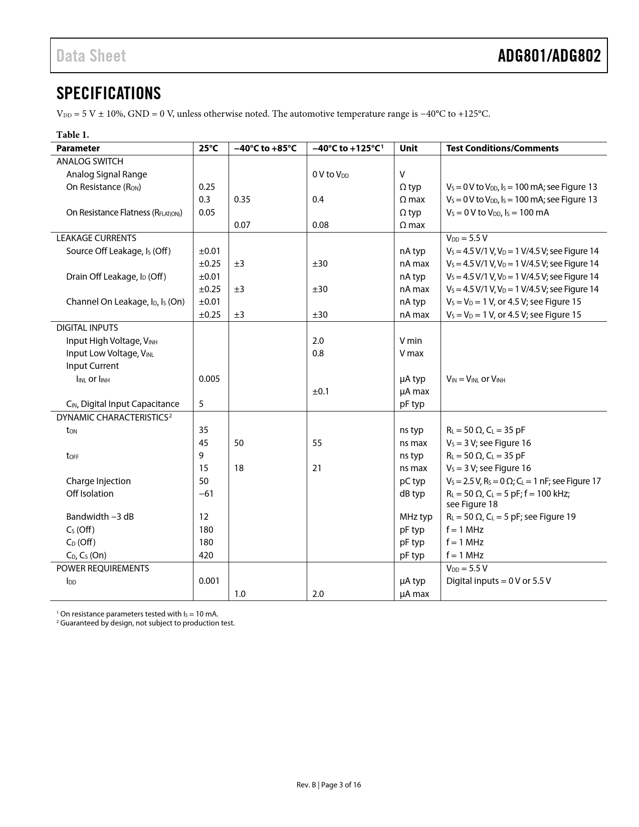

Data Sheet. ADG801/ADG802. SPECIFICATIONS. Table 1. Parameter. 25°C. −40°C to +85°C. −40°C to +125°C1. Unit. Test Conditions/Comments
Data Sheet ADG801/ADG802 SPECIFICATIONS Table 1 Parameter 25°C −40°C to +85°C −40°C to +125°C1 Unit Test Conditions/Comments
link to page 3 link to page 10 link to page 10 link to page 10 link to page 10 link to page 10 link to page 10 link to page 10 link to page 10 link to page 3 link to page 10 link to page 10 link to page 10 link to page 11 link to page 11
VDD = 5 V ± 10%, GND = 0 V, unless otherwise noted. The automotive temperature range is −40°C to +125°C.
Table 1. Parameter 25°C −40°C to +85°C −40°C to +125°C1 Unit Test Conditions/Comments
ANALOG SWITCH Analog Signal Range 0 V to VDD V On Resistance (RON) 0.25 Ω typ VS = 0 V to VDD, IS = 100 mA; see Figure 13 0.3 0.35 0.4 Ω max VS = 0 V to VDD, IS = 100 mA; see Figure 13 On Resistance Flatness (RFLAT(ON)) 0.05 Ω typ VS = 0 V to VDD, IS = 100 mA 0.07 0.08 Ω max LEAKAGE CURRENTS VDD = 5.5 V Source Off Leakage, IS (Off ) ±0.01 nA typ VS = 4.5 V/1 V, VD = 1 V/4.5 V; see Figure 14 ±0.25 ±3 ±30 nA max VS = 4.5 V/1 V, VD = 1 V/4.5 V; see Figure 14 Drain Off Leakage, ID (Off ) ±0.01 nA typ VS = 4.5 V/1 V, VD = 1 V/4.5 V; see Figure 14 ±0.25 ±3 ±30 nA max VS = 4.5 V/1 V, VD = 1 V/4.5 V; see Figure 14 Channel On Leakage, ID, IS (On) ±0.01 nA typ VS = VD = 1 V, or 4.5 V; see Figure 15 ±0.25 ±3 ±30 nA max VS = VD = 1 V, or 4.5 V; see Figure 15 DIGITAL INPUTS Input High Voltage, VINH 2.0 V min Input Low Voltage, VINL 0.8 V max Input Current IINL or IINH 0.005 μA typ VIN = VINL or VINH ±0.1 μA max CIN, Digital Input Capacitance 5 pF typ DYNAMIC CHARACTERISTICS2 tON 35 ns typ RL = 50 Ω, CL = 35 pF 45 50 55 ns max VS = 3 V; see Figure 16 tOFF 9 ns typ RL = 50 Ω, CL = 35 pF 15 18 21 ns max VS = 3 V; see Figure 16 Charge Injection 50 pC typ VS = 2.5 V, RS = 0 Ω; CL = 1 nF; see Figure 17 Off Isolation −61 dB typ RL = 50 Ω, CL = 5 pF; f = 100 kHz; see Figure 18 Bandwidth −3 dB 12 MHz typ RL = 50 Ω, CL = 5 pF; see Figure 19 CS (Off ) 180 pF typ f = 1 MHz CD (Off ) 180 pF typ f = 1 MHz CD, CS (On) 420 pF typ f = 1 MHz POWER REQUIREMENTS VDD = 5.5 V IDD 0.001 μA typ Digital inputs = 0 V or 5.5 V 1.0 2.0 μA max 1 On resistance parameters tested with IS = 10 mA. 2 Guaranteed by design, not subject to production test. Rev. B | Page 3 of 16 Document Outline FEATURES APPLICATIONS GENERAL DESCRIPTION FUNCTIONAL BLOCK DIAGRAM PRODUCT HIGHLIGHTS TABLE OF CONTENTS REVISION HISTORY SPECIFICATIONS ABSOLUTE MAXIMUM RATINGS ESD CAUTION PIN CONFIGURATIONS AND FUNCTION DESCRIPTIONS TYPICAL PERFORMANCE CHARACTERISTICS TERMINOLOGY TEST CIRCUITS OUTLINE DIMENSIONS ORDERING GUIDE
