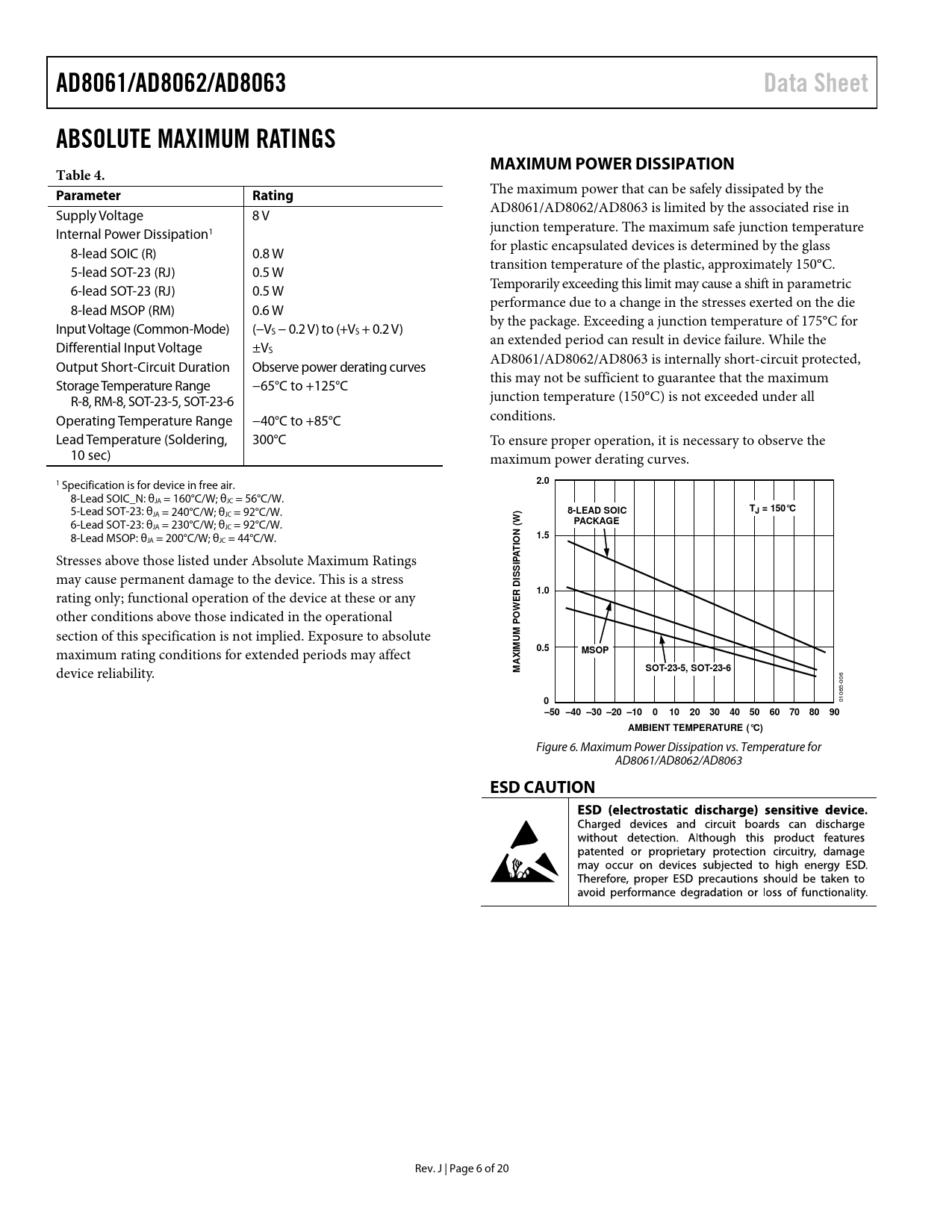

AD8061/AD8062/AD8063. Data Sheet. ABSOLUTE MAXIMUM RATINGS. MAXIMUM POWER DISSIPATION. Table 4. Parameter. Rating. 2.0. 8-LEAD SOIC
AD8061/AD8062/AD8063 Data Sheet ABSOLUTE MAXIMUM RATINGS MAXIMUM POWER DISSIPATION Table 4 Parameter Rating 2.0 8-LEAD SOIC
link to page 6
AD8061/AD8062/AD8063 Data Sheet ABSOLUTE MAXIMUM RATINGS MAXIMUM POWER DISSIPATION Table 4. Parameter Rating
The maximum power that can be safely dissipated by the Supply Voltage 8 V AD8061/AD8062/AD8063 is limited by the associated rise in Internal Power Dissipation1 junction temperature. The maximum safe junction temperature 8-lead SOIC (R) 0.8 W for plastic encapsulated devices is determined by the glass 5-lead SOT-23 (RJ) 0.5 W transition temperature of the plastic, approximately 150°C. 6-lead SOT-23 (RJ) 0.5 W Temporarily exceeding this limit may cause a shift in parametric 8-lead MSOP (RM) 0.6 W performance due to a change in the stresses exerted on the die Input Voltage (Common-Mode) (−V by the package. Exceeding a junction temperature of 175°C for S − 0.2 V) to (+VS + 0.2 V) Differential Input Voltage ±V an extended period can result in device failure. While the S AD8061/AD8062/AD8063 is internally short-circuit protected, Output Short-Circuit Duration Observe power derating curves this may not be sufficient to guarantee that the maximum Storage Temperature Range −65°C to +125°C R-8, RM-8, SOT-23-5, SOT-23-6 junction temperature (150°C) is not exceeded under all Operating Temperature Range −40°C to +85°C conditions. Lead Temperature (Soldering, 300°C To ensure proper operation, it is necessary to observe the 10 sec) maximum power derating curves. 1 Specification is for device in free air.
2.0
8-Lead SOIC_N: θJA = 160°C/W; θJC = 56°C/W. 5-Lead SOT-23: θ
T
JA = 240°C/W; θJC = 92°C/W.
8-LEAD SOIC J = 150°C
6-Lead SOT-23: θ
W) PACKAGE
JA = 230°C/W; θJC = 92°C/W.
8-Lead MSOP: θ
1.5
JA = 200°C/W; θJC = 44°C/W.
TION
Stresses above those listed under Absolute Maximum Ratings
PA
may cause permanent damage to the device. This is a stress
ISSI D
rating only; functional operation of the device at these or any
1.0 ER
other conditions above those indicated in the operational
W
section of this specification is not implied. Exposure to absolute
M PO
maximum rating conditions for extended periods may affect
MU 0.5 MSOP XI
device reliability.
MA SOT-23-5, SOT-23-6
006
0
01065-
–50 –40 –30 –20 –10 0 10 20 30 40 50 60 70 80 90 AMBIENT TEMPERATURE (°C)
Figure 6. Maximum Power Dissipation vs. Temperature for AD8061/AD8062/AD8063
