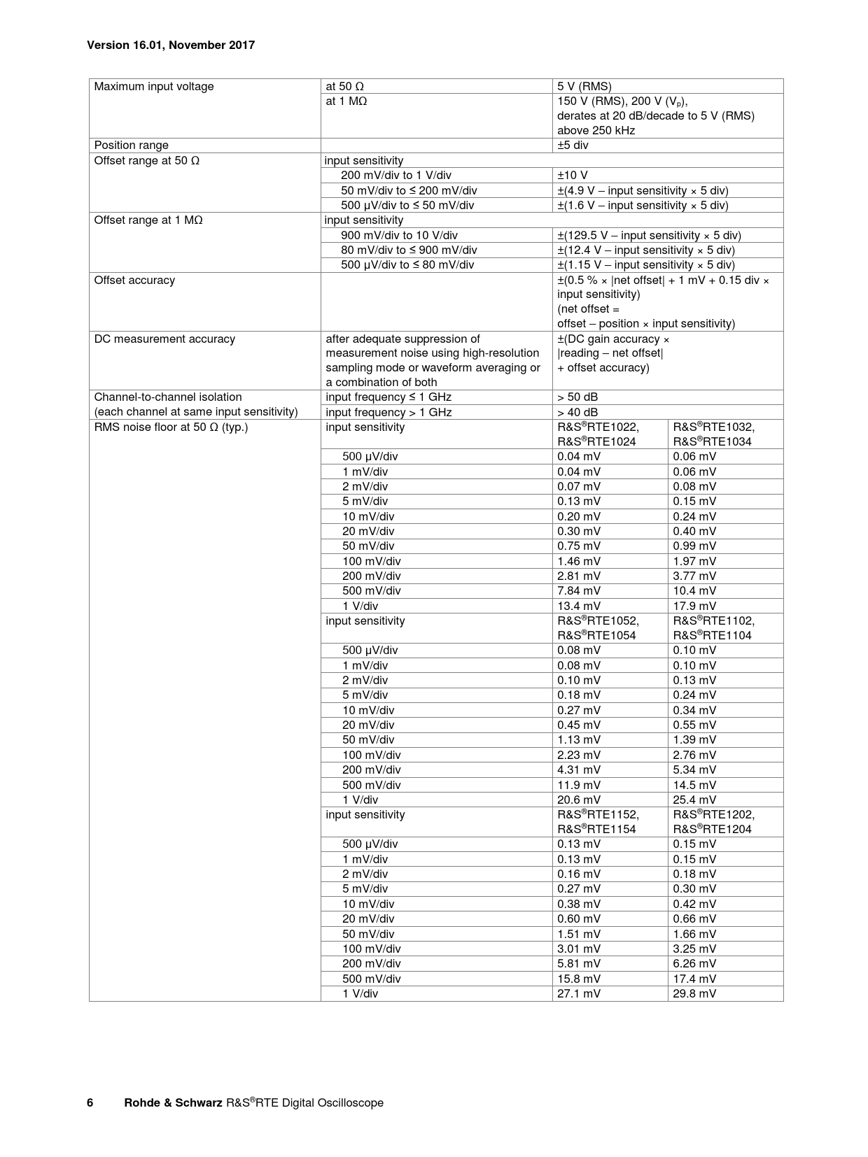

Maximum input voltage at 50 Ω 5 V (RMS) at 1 MΩ 150 V (RMS), 200 V (Vp), derates at 20 dB/decade to 5 V (RMS) above 250 kHz Position range ±5 div Offset range at 50 Ω input sensitivity 200 mV/div to 1 V/div ±10 V 50 mV/div to ≤ 200 mV/div ±(4.9 V – input sensitivity × 5 div) 500 μV/div to ≤ 50 mV/div ±(1.6 V – input sensitivity × 5 div) Offset range at 1 MΩ input sensitivity 900 mV/div to 10 V/div ±(129.5 V – input sensitivity × 5 div) 80 mV/div to ≤ 900 mV/div ±(12.4 V – input sensitivity × 5 div) 500 μV/div to ≤ 80 mV/div ±(1.15 V – input sensitivity × 5 div) Offset accuracy ±(0.5 % × |net offset| + 1 mV + 0.15 div × input sensitivity) (net offset = offset – position × input sensitivity) DC measurement accuracy after adequate suppression of ±(DC gain accuracy × measurement noise using high-resolution |reading – net offset| sampling mode or waveform averaging or + offset accuracy) a combination of both Channel-to-channel isolation input frequency ≤ 1 GHz > 50 dB (each channel at same input sensitivity) input frequency > 1 GHz > 40 dB RMS noise floor at 50 Ω (typ.) input sensitivity R&S®RTE1022, R&S®RTE1032, R&S®RTE1024 R&S®RTE1034 500 μV/div 0.04 mV 0.06 mV 1 mV/div 0.04 mV 0.06 mV 2 mV/div 0.07 mV 0.08 mV 5 mV/div 0.13 mV 0.15 mV 10 mV/div 0.20 mV 0.24 mV 20 mV/div 0.30 mV 0.40 mV 50 mV/div 0.75 mV 0.99 mV 100 mV/div 1.46 mV 1.97 mV 200 mV/div 2.81 mV 3.77 mV 500 mV/div 7.84 mV 10.4 mV 1 V/div 13.4 mV 17.9 mV input sensitivity R&S®RTE1052, R&S®RTE1102, R&S®RTE1054 R&S®RTE1104 500 μV/div 0.08 mV 0.10 mV 1 mV/div 0.08 mV 0.10 mV 2 mV/div 0.10 mV 0.13 mV 5 mV/div 0.18 mV 0.24 mV 10 mV/div 0.27 mV 0.34 mV 20 mV/div 0.45 mV 0.55 mV 50 mV/div 1.13 mV 1.39 mV 100 mV/div 2.23 mV 2.76 mV 200 mV/div 4.31 mV 5.34 mV 500 mV/div 11.9 mV 14.5 mV 1 V/div 20.6 mV 25.4 mV input sensitivity R&S®RTE1152, R&S®RTE1202, R&S®RTE1154 R&S®RTE1204 500 μV/div 0.13 mV 0.15 mV 1 mV/div 0.13 mV 0.15 mV 2 mV/div 0.16 mV 0.18 mV 5 mV/div 0.27 mV 0.30 mV 10 mV/div 0.38 mV 0.42 mV 20 mV/div 0.60 mV 0.66 mV 50 mV/div 1.51 mV 1.66 mV 100 mV/div 3.01 mV 3.25 mV 200 mV/div 5.81 mV 6.26 mV 500 mV/div 15.8 mV 17.4 mV 1 V/div 27.1 mV 29.8 mV
