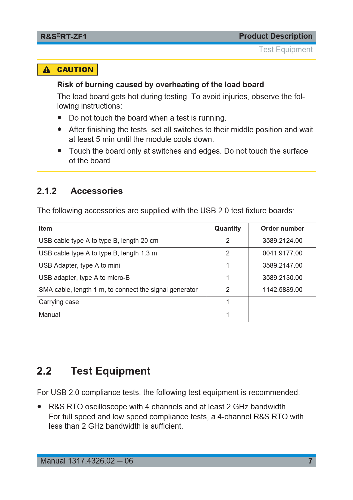

Risk of burning caused by overheating of the load board
The load board gets hot during testing. To avoid injuries, observe the fol- lowing instructions: ● Do not touch the board when a test is running. ● After finishing the tests, set all switches to their middle position and wait at least 5 min until the module cools down. ● Touch the board only at switches and edges. Do not touch the surface of the board.
2.1.2 Accessories
The following accessories are supplied with the USB 2.0 test fixture boards:
Item Quantity Order number
USB cable type A to type B, length 20 cm 2 3589.2124.00 USB cable type A to type B, length 1.3 m 2 0041.9177.00 USB Adapter, type A to mini 1 3589.2147.00 USB adapter, type A to micro-B 1 3589.2130.00 SMA cable, length 1 m, to connect the signal generator 2 1142.5889.00 Carrying case 1 Manual 1
2.2 Test Equipment
For USB 2.0 compliance tests, the following test equipment is recommended: ● R&S RTO oscilloscope with 4 channels and at least 2 GHz bandwidth. For full speed and low speed compliance tests, a 4-channel R&S RTO with less than 2 GHz bandwidth is sufficient. Manual 1317.4326.02 ─ 06
