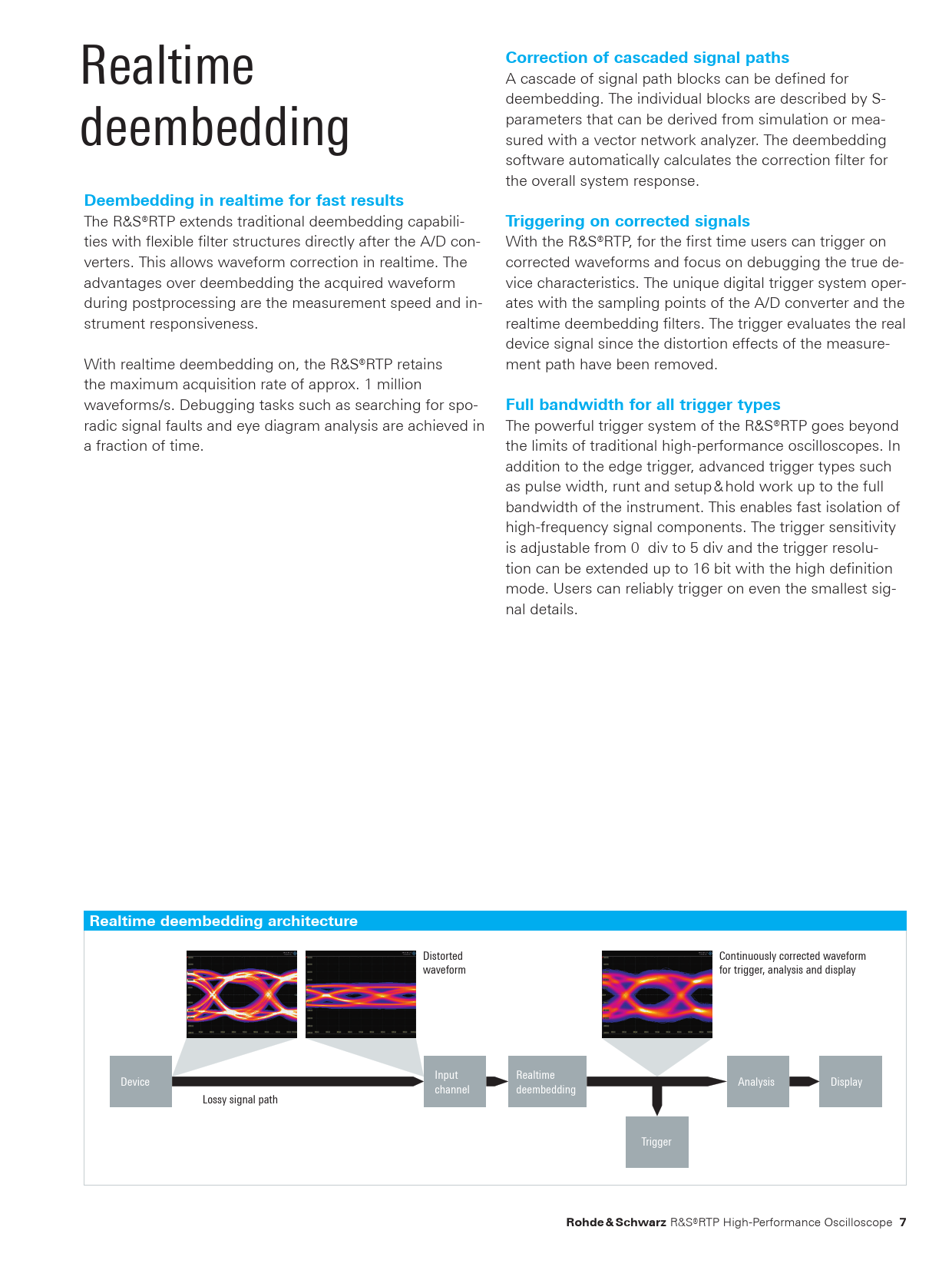

Realtime
Correction of cascaded signal paths
A cascade of signal path blocks can be defined for deembedding deembedding. The individual blocks are described by S- parameters that can be derived from simulation or mea- sured with a vector network analyzer. The deembedding software automatically calculates the correction filter for the overall system response.
Deembedding in realtime for fast results
The R&S®RTP extends traditional deembedding capabili-
Triggering on corrected signals
ties with flexible filter structures directly after the A/D con- With the R&S®RTP, for the first time users can trigger on verters. This allows waveform correction in realtime. The corrected waveforms and focus on debugging the true de- advantages over deembedding the acquired waveform vice characteristics. The unique digital trigger system oper- during postprocessing are the measurement speed and in- ates with the sampling points of the A/D converter and the strument responsiveness. realtime deembedding filters. The trigger evaluates the real device signal since the distortion effects of the measure- With realtime deembedding on, the R&S®RTP retains ment path have been removed. the maximum acquisition rate of approx. 1 million waveforms/s. Debugging tasks such as searching for spo-
Full bandwidth for all trigger types
radic signal faults and eye diagram analysis are achieved in The powerful trigger system of the R&S®RTP goes beyond a fraction of time. the limits of traditional high-performance oscilloscopes. In addition to the edge trigger, advanced trigger types such as pulse width, runt and setup & hold work up to the full bandwidth of the instrument. This enables fast isolation of high-frequency signal components. The trigger sensitivity is adjustable from 0  div to 5 div and the trigger resolu- tion can be extended up to 16 bit with the high definition mode. Users can reliably trigger on even the smallest sig- nal details.
Realtime deembedding architecture
Distorted Continuously corrected waveform waveform for trigger, analysis and display Input Realtime Device Analysis Display channel deembedding Lossy signal path Trigger
