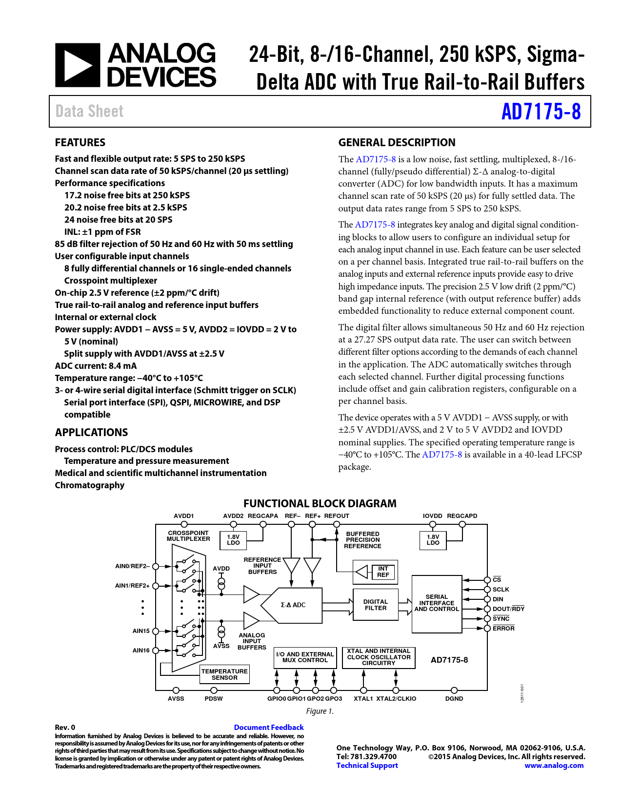

Description24-Bit, 8-/16-Channel, 250 kSPS, Sigma-Delta ADC with True Rail-to-Rail Buffers
Pages / Page65 / 1 — 24-Bit, 8-/16-Channel, 250 kSPS, Sigma-. Delta ADC with True Rail-to-Rail …
24-Bit, 8-/16-Channel, 250 kSPS, Sigma-. Delta ADC with True Rail-to-Rail Buffers. Data Sheet. AD7175-8. FEATURES
Datasheet AD7175-8 Analog Devices
24-Bit, 8-/16-Channel, 250 kSPS, Sigma- Delta ADC with True Rail-to-Rail Buffers Data Sheet AD7175-8 FEATURES GENERAL DESCRIPTION Fast and flexible output rate: 5 SPS to 250 kSPS
The AD7175-8 is a low noise, fast settling, multiplexed, 8-/16-
Channel scan data rate of 50 kSPS/channel (20 µs settling)
channel (fully/pseudo differential) Σ-Δ analog-to-digital
Performance specifications
converter (ADC) for low bandwidth inputs. It has a maximum
17.2 noise free bits at 250 kSPS
channel scan rate of 50 kSPS (20 µs) for fully settled data. The
20.2 noise free bits at 2.5 kSPS
output data rates range from 5 SPS to 250 kSPS.
24 noise free bits at 20 SPS
The AD7175-8 integrates key analog and digital signal condition-
INL: ±1 ppm of FSR
ing blocks to allow users to configure an individual setup for
85 dB filter rejection of 50 Hz and 60 Hz with 50 ms settling
each analog input channel in use. Each feature can be user selected
User configurable input channels
on a per channel basis. Integrated true rail-to-rail buffers on the
8 fully differential channels or 16 single-ended channels
analog inputs and external reference inputs provide easy to drive
Crosspoint multiplexer
high impedance inputs. The precision 2.5 V low drift (2 ppm/°C)
On-chip 2.5 V reference (±2 ppm/°C drift)
band gap internal reference (with output reference buffer) adds
True rail-to-rail analog and reference input buffers
embedded functionality to reduce external component count.
Internal or external clock Power supply: AVDD1 − AVSS = 5 V, AVDD2 = IOVDD = 2 V to
The digital filter allows simultaneous 50 Hz and 60 Hz rejection
5 V (nominal)
at a 27.27 SPS output data rate. The user can switch between
Split supply with AVDD1/AVSS at ±2.5 V
different filter options according to the demands of each channel
ADC current: 8.4 mA
in the application. The ADC automatical y switches through
Temperature range: −40°C to +105°C
each selected channel. Further digital processing functions
3- or 4-wire serial digital interface (Schmitt trigger on SCLK)
include offset and gain calibration registers, configurable on a
Serial port interface (SPI), QSPI, MICROWIRE, and DSP
per channel basis.
compatible
The device operates with a 5 V AVDD1 − AVSS supply, or with
APPLICATIONS
±2.5 V AVDD1/AVSS, and 2 V to 5 V AVDD2 and IOVDD nominal supplies. The specified operating temperature range is
Process control: PLC/DCS modules
−40°C to +105°C. The AD7175-8 is available in a 40-lead LFCSP
Temperature and pressure measurement
package.
Medical and scientific multichannel instrumentation Chromatography FUNCTIONAL BLOCK DIAGRAM AVDD1 AVDD2 REGCAPA REF– REF+ REFOUT IOVDD REGCAPD CROSSPOINT BUFFERED 1.8V MULTIPLEXER 1.8V PRECISION LDO LDO REFERENCE REFERENCE AIN0/REF2– AVDD INPUT INT BUFFERS REF CS AIN1/REF2+ SCLK SERIAL DIN Σ-Δ ADC DIGITAL INTERFACE FILTER AND CONTROL DOUT/RDY SYNC AIN15 ERROR ANALOG INPUT AVSS BUFFERS AIN16 XTAL AND INTERNAL I/O AND EXTERNAL CLOCK OSCILLATOR MUX CONTROL AD7175-8 CIRCUITRY TEMPERATURE SENSOR
001 1- 1
AVSS PDSW GPIO0 GPIO1 GPO2 GPO3 XTAL1 XTAL2/CLKIO DGND
129 Figure 1.
