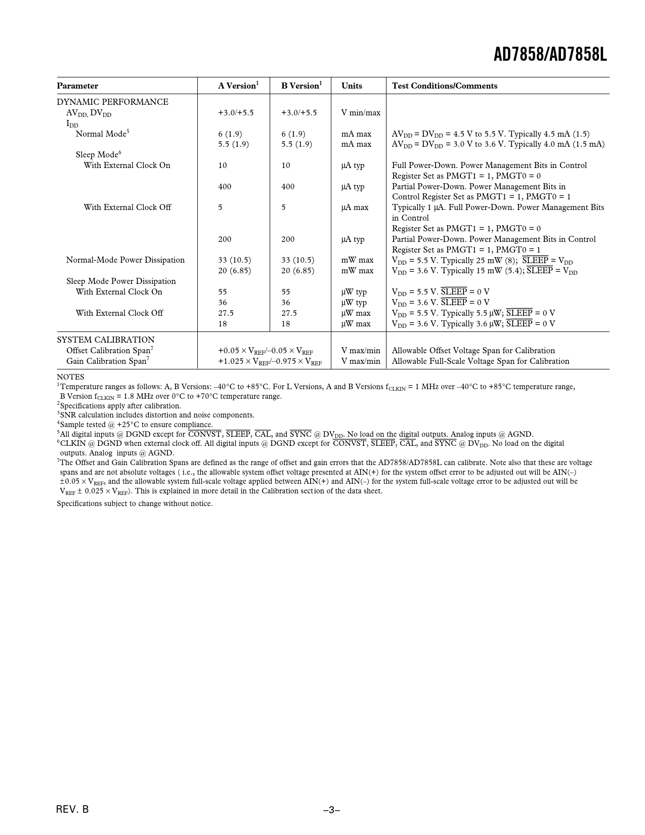

AD7858/AD7858L. Parameter. A Version1. B Version1. Units. Test Conditions/Comments
AD7858/AD7858L Parameter A Version1 B Version1 Units Test Conditions/Comments
DYNAMIC PERFORMANCE AVDD, DVDD +3.0/+5.5 +3.0/+5.5 V min/max IDD Normal Mode5 6 (1.9) 6 (1.9) mA max AVDD = DVDD = 4.5 V to 5.5 V. Typically 4.5 mA (1.5) 5.5 (1.9) 5.5 (1.9) mA max AVDD = DVDD = 3.0 V to 3.6 V. Typically 4.0 mA (1.5 mA) Sleep Mode6 With External Clock On 10 10 µA typ Full Power-Down. Power Management Bits in Control Register Set as PMGT1 = 1, PMGT0 = 0 400 400 µA typ Partial Power-Down. Power Management Bits in Control Register Set as PMGT1 = 1, PMGT0 = 1 With External Clock Off 5 5 µA max Typically 1 µA. Full Power-Down. Power Management Bits in Control Register Set as PMGT1 = 1, PMGT0 = 0 200 200 µA typ Partial Power-Down. Power Management Bits in Control Register Set as PMGT1 = 1, PMGT0 = 1 Normal-Mode Power Dissipation 33 (10.5) 33 (10.5) mW max VDD = 5.5 V. Typically 25 mW (8); SLEEP = VDD 20 (6.85) 20 (6.85) mW max VDD = 3.6 V. Typically 15 mW (5.4); SLEEP = VDD Sleep Mode Power Dissipation With External Clock On 55 55 µW typ VDD = 5.5 V. SLEEP = 0 V 36 36 µW typ VDD = 3.6 V. SLEEP = 0 V With External Clock Off 27.5 27.5 µW max VDD = 5.5 V. Typically 5.5 µW; SLEEP = 0 V 18 18 µW max VDD = 3.6 V. Typically 3.6 µW; SLEEP = 0 V SYSTEM CALIBRATION Offset Calibration Span7 +0.05 × VREF/–0.05 × VREF V max/min Allowable Offset Voltage Span for Calibration Gain Calibration Span7 +1.025 × VREF/–0.975 × VREF V max/min Allowable Full-Scale Voltage Span for Calibration NOTES 1Temperature ranges as follows: A, B Versions: –40°C to +85°C. For L Versions, A and B Versions fCLKIN = 1 MHz over –40°C to +85°C temperature range, B Version fCLKIN = 1.8 MHz over 0°C to +70°C temperature range. 2Specifications apply after calibration. 3SNR calculation includes distortion and noise components. 4Sample tested @ +25°C to ensure compliance. 5All digital inputs @ DGND except for CONVST, SLEEP, CAL, and SYNC @ DVDD. No load on the digital outputs. Analog inputs @ AGND. 6CLKIN @ DGND when external clock off. All digital inputs @ DGND except for CONVST, SLEEP, CAL, and SYNC @ DVDD. No load on the digital outputs. Analog inputs @ AGND. 7The Offset and Gain Calibration Spans are defined as the range of offset and gain errors that the AD7858/AD7858L can calibrate. Note also that these are voltage spans and are not absolute voltages ( i.e., the allowable system offset voltage presented at AIN(+) for the system offset error to be adjusted out will be AIN(–) ± 0.05 × VREF, and the allowable system full-scale voltage applied between AIN(+) and AIN(–) for the system full-scale voltage error to be adjusted out will be VREF ± 0.025 × VREF). This is explained in more detail in the Calibration section of the data sheet. Specifications subject to change without notice. REV. B –3–
