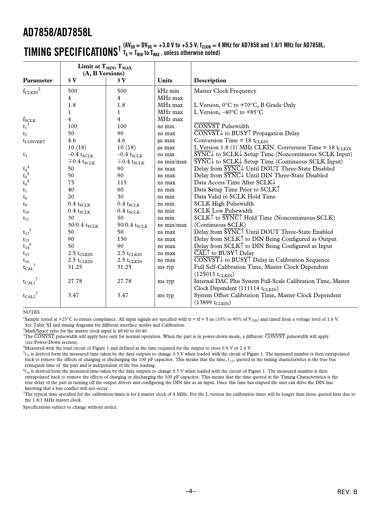

AD7858/AD7858L. (AVDD = DVDD = +3.0 V to +5.5 V; fCLKIN = 4 MHz for AD7858 and 1.8/1 MHz for AD7858L;
AD7858/AD7858L (AVDD = DVDD = +3.0 V to +5.5 V; fCLKIN = 4 MHz for AD7858 and 1.8/1 MHz for AD7858L;
AD7858/AD7858L (AVDD = DVDD = +3.0 V to +5.5 V; fCLKIN = 4 MHz for AD7858 and 1.8/1 MHz for AD7858L; TIMING SPECIFICATIONS1 TA = TMIN to TMAX , unless otherwise noted) Limit at TMIN, TMAX (A, B Versions) Parameter 5 V 3 V Units Description
