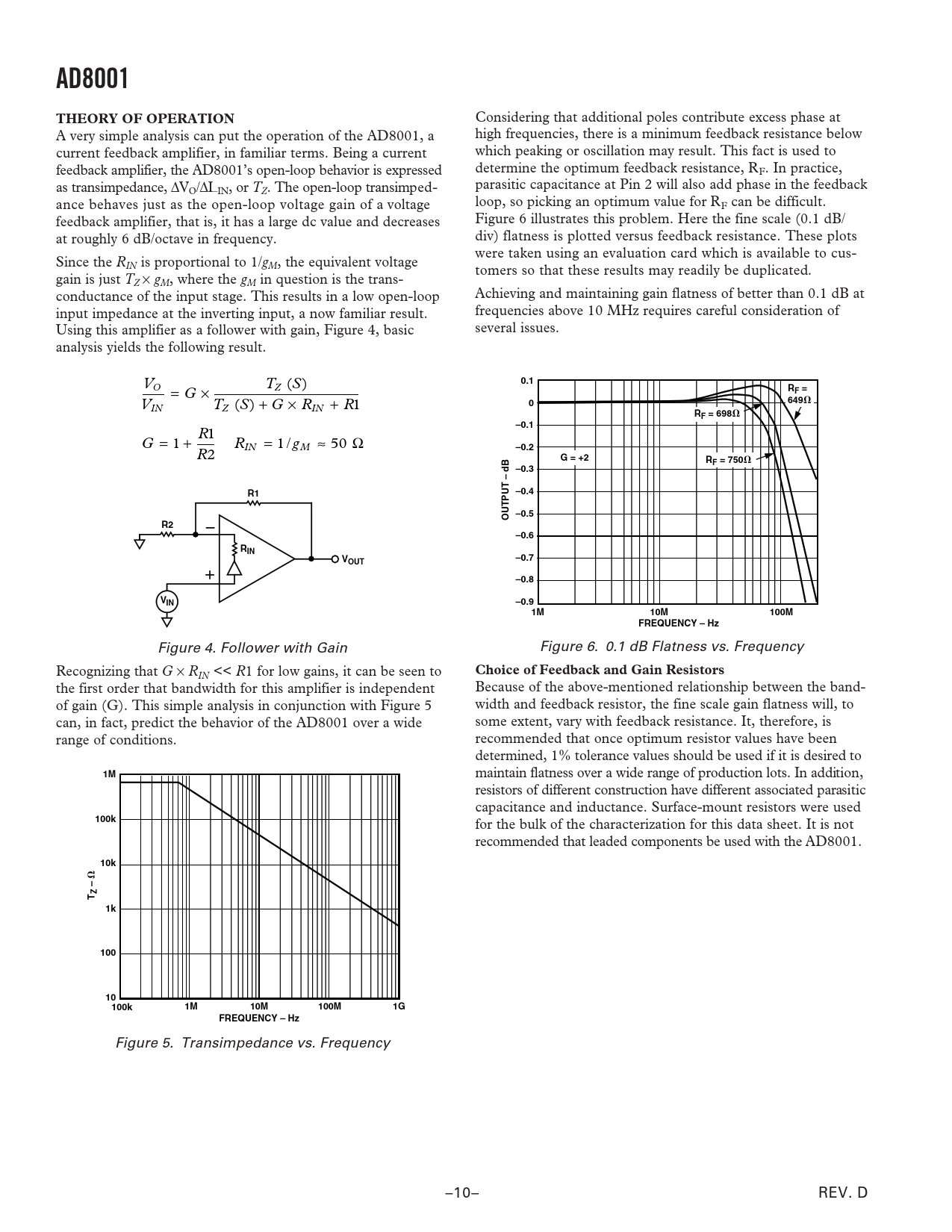

Considering that additional poles contribute excess phase at A very simple analysis can put the operation of the AD8001, a high frequencies, there is a minimum feedback resistance below current feedback amplifier, in familiar terms. Being a current which peaking or oscillation may result. This fact is used to feedback amplifier, the AD8001’s open-loop behavior is expressed determine the optimum feedback resistance, RF. In practice, as transimpedance, ∆V parasitic capacitance at Pin 2 will also add phase in the feedback O/∆I–IN, or TZ. The open-loop transimped- ance behaves just as the open-loop voltage gain of a voltage loop, so picking an optimum value for RF can be difficult. feedback amplifier, that is, it has a large dc value and decreases Figure 6 illustrates this problem. Here the fine scale (0.1 dB/ at roughly 6 dB/octave in frequency. div) flatness is plotted versus feedback resistance. These plots were taken using an evaluation card which is available to cus- Since the RIN is proportional to 1/gM, the equivalent voltage tomers so that these results may readily be duplicated. gain is just T × Z gM, where the gM in question is the trans- conductance of the input stage. This results in a low open-loop Achieving and maintaining gain flatness of better than 0.1 dB at input impedance at the inverting input, a now familiar result. frequencies above 10 MHz requires careful consideration of Using this amplifier as a follower with gain, Figure 4, basic several issues. analysis yields the following result. V

O TZ S = ( ) G ×
RF =
V ( ) + × +
0 649
IN TZ S G RIN R1
RF = 698 –0.1
R1 G = 1 + R = 1/ ≈ IN gM 50 Ω
–0.2
R2
G = +2 RF = 750 –0.3 R1 –0.4 OUTPUT – dB –0.5 R2 –0.6 RIN V –0.7 OUT –0.8 VIN –0.9 1M 10M 100M FREQUENCY – Hz
Figure 4. Follower with Gain Figure 6. 0.1 dB Flatness vs. Frequency Recognizing that G × R
Choice of Feedback and Gain Resistors
IN << R1 for low gains, it can be seen to the first order that bandwidth for this amplifier is independent Because of the above-mentioned relationship between the band- of gain (G). This simple analysis in conjunction with Figure 5 width and feedback resistor, the fine scale gain flatness will, to can, in fact, predict the behavior of the AD8001 over a wide some extent, vary with feedback resistance. It, therefore, is range of conditions. recommended that once optimum resistor values have been determined, 1% tolerance values should be used if it is desired to

maintain flatness over a wide range of production lots. In addition, resistors of different construction have different associated parasitic capacitance and inductance. Surface-mount resistors were used
100k
for the bulk of the characterization for this data sheet. It is not recommended that leaded components be used with the AD8001.
10k – ZT 1k 100 10 100k 1M 10M 100M 1G FREQUENCY – Hz
