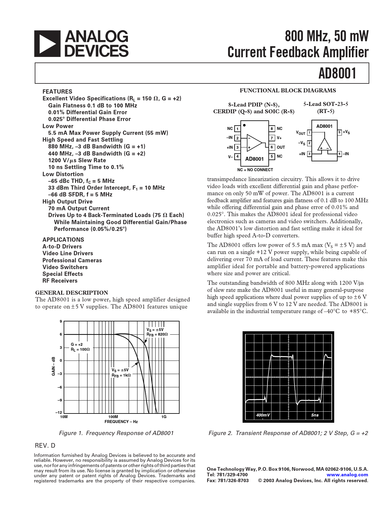

800 MHz, 50 mW Current Feedback Amplifier AD8001 FEATURES FUNCTIONAL BLOCK DIAGRAMS Excellent Video Specifications (RL = 150 , G = +2) Gain Flatness 0.1 dB to 100 MHz 8-Lead PDIP (N-8), 5-Lead SOT-23-5 0.01% Differential Gain Error CERDIP (Q-8) and SOIC (R-8) (RT-5) 0.025 Differential Phase Error Low Power AD8001 NC 1 8 NC 5.5 mA Max Power Supply Current (55 mW) V 1 5 +V OUT S High Speed and Fast Settling –IN 2 7 V+ –V 2 880 MHz, –3 dB Bandwidth (G = +1) S +IN 3 6 OUT 440 MHz, –3 dB Bandwidth (G = +2) +IN 3 4 –IN V– 4 5 NC 1200 V/ s Slew Rate AD8001 10 ns Settling Time to 0.1% NC = NO CONNECT Low Distortion –65 dBc THD, f

mance on only 50 mW of power. The AD8001 is a current
High Output Drive
feedback amplifier and features gain flatness of 0.1 dB to 100 MHz
70 mA Output Current
while offering differential gain and phase error of 0.01% and
Drives Up to 4 Back-Terminated Loads (75 Each)
0.025°. This makes the AD8001 ideal for professional video
While Maintaining Good Differential Gain/Phase
electronics such as cameras and video switchers. Additionally,
Performance (0.05%/0.25 )
the AD8001’s low distortion and fast settling make it ideal for buffer high speed A-to-D converters.

9 VS = 5V 6 RFB = 820 G = +2 3 RL = 100 0 VS = 5V GAIN – dB –3 RFB = 1k –6 –9 –12 10M 100M 1G FREQUENCY – Hz
Figure 1. Frequency Response of AD8001 Figure 2. Transient Response of AD8001; 2 V Step, G = +2 REV. D Information furnished by Analog Devices is believed to be accurate and reliable. However, no responsibility is assumed by Analog Devices for its use, nor for any infringements of patents or other rights of third parties that may result from its use. No license is granted by implication or otherwise
