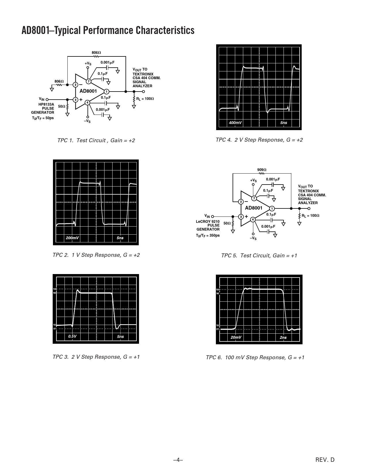

AD8001–Typical Performance Characteristics. 806. 0.001. VOUT TO. 0.1. TEKTRONIX CSA 404 COMM. SIGNAL ANALYZER. AD8001. L = 100. HP8133A
AD8001–Typical Performance Characteristics 806 0.001 VOUT TO 0.1 TEKTRONIX CSA 404 COMM SIGNAL ANALYZER AD8001 L = 100 HP8133A
AD8001–Typical Performance Characteristics 806 +V 0.001 F S VOUT TO 0.1 F TEKTRONIX CSA 404 COMM. 806 SIGNAL ANALYZER AD8001 V 0.1 F R IN L = 100 HP8133A 50 PULSE 0.001 F GENERATOR TR/TF = 50ps –VS 400mV 5ns
TPC 1. Test Circuit , Gain = +2 TPC 4. 2 V Step Response, G = +2
909 +V 0.001 F S VOUT TO 0.1 F TEKTRONIX CSA 404 COMM. SIGNAL ANALYZER AD8001 V 0.1 F R IN L = 100 LeCROY 9210 50 PULSE 0.001 F GENERATOR TR/TF = 350ps –VS
TPC 2. 1 V Step Response, G = +2 TPC 5. Test Circuit, Gain = +1
0.5V 5ns
TPC 3. 2 V Step Response, G = +1 TPC 6. 100 mV Step Response, G = +1 –4– REV. D Document Outline FEATURES APPLICATIONS GENERAL DESCRIPTION FUNCTIONAL BLOCK DIAGRAMS SPECIFICATIONS ABSOLUTE MAXIMUM RATINGS ORDERING GUIDE MAXIMUM POWER DISSIPATION Typical Performance Characteristics THEORY OF OPERATION Choice of Feedback and Gain Resistors Printed Circuit Board Layout Considerations Power Supply Bypassing DC Errors and Noise Driving Capacitive Loads Communications Operation as a Video Line Driver Driving A-to-D Converters Layout Considerations OUTLINE DIMENSIONS Revision History
