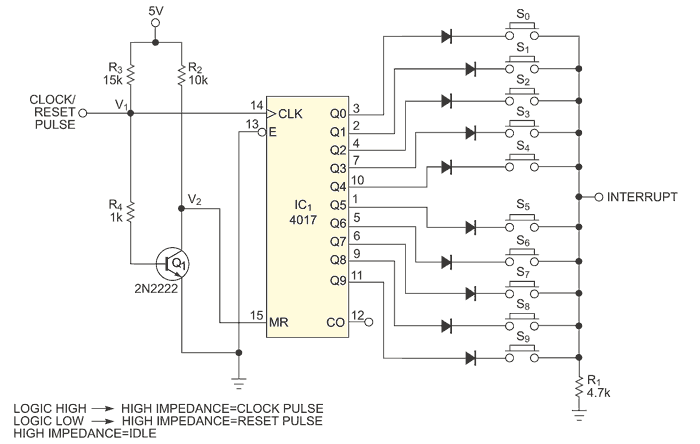

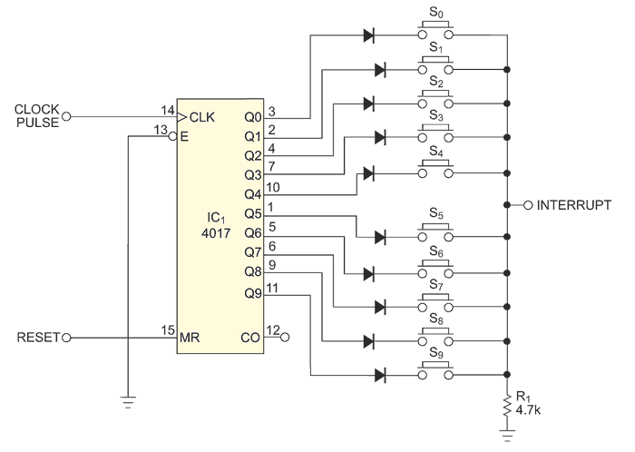

This Design Idea describes a method for reading multiple pushbuttons or open/closed switches using only two digital I/O pins and a timer interrupt of the MCU (Figure 1). Optionally, a third I/O pin can be assigned to periodically reset the CD4017 (a cascadable decoded 1-of-10 Johnson counter) for reliable operation should an EMI or ESD event occur that could falsely clock the counter, or you can use the circuit shown in Figure 2 and retain the two-pin feature. The diodes isolate the counter outputs in the event that two or more switches are closed at the same time. You can increase the number of switches connected by cascading multiple CD4017 ICs using a carry-out signal (pin 12) and a clock signal (pin 14).
 Read 10 or more switches using only two I/O pins of a microcontroller
Figure 1. You can easily expand this circuit to many more than 10 switches, yet still use only two MCU I/O pins, by cascading multiple CD4017 counters through their carry-outs to the following enables.
Reliable operation following the initial power-up reset depends on the CD4017 counter’s remaining synchronized with the MCU counter. This synchronization can be upset by an ESD or EMI event such as a nearby cell phone, so it would be wise to include in the firmware a periodic hardware reset to the CD4017 to keep the counts synchronized. Figure 2 shows how you can do this without having to use a third MCU pin.
Figure 2. You can add three resistors and a transistor to implement the occasional synchronizing reset without using a third I/O pin.
For this function, you use the MCU’s ability to keep its I/O pin in three different states: high, low, and, by temporarily changing the pin to an input, high impedance.
In the logic-high state, transistor Q1 turns on through R4, making the voltage on V1 logic high and the voltage on V2 below the logic-low level. This sets the clock pin to a logic high while keeping the reset pin at a logic low.
In the logic-low state, transistor Q1 turns off, making the voltage on V1 logic low and the voltage on V2 above the logic-high level. This sets the reset pin to logic high while keeping the clock in the logic-low state.
In the idle high-impedance state, transistor Q1 is turned on through R3 and R4, making the voltage on V1 and V2 below the logic-low level. This sets both the clock and reset pins of the CD4017 to a logic-low state.
To send a clock edge, therefore, change the state in the following manner: high impedance > logic high > high impedance. Likewise, to reset the CD4017, change the state as follows: high impedance > logic low > high impedance.
