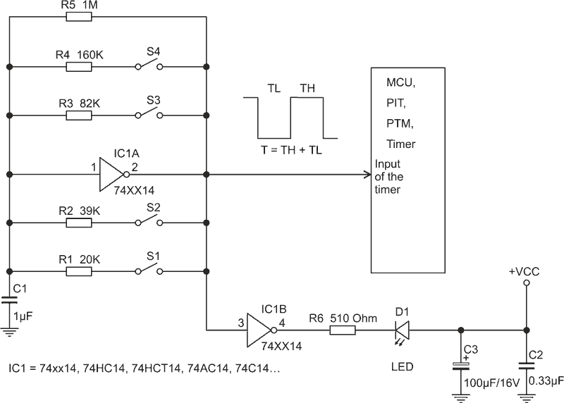

Monitoring multiple contacts with a single inverter
A single inverter can also capture information from one or more contact sensors or switches. Figure 2 shows how a single Schmitt captures the status of four contacts, S1 to S4. The circuit converts the resistance in the feedback of IC1a into frequency. Diodes could also be added as in Figure 1 to increase the number of contacts.
Single inverter with Schmitt is serving many contact sensors
Figure 2. Single inverter with Schmitt is serving many contact sensors.
There are 16 possible combinations of open and closed switches. Each combination produces a square wave with predefined frequency. The frequencies can be measured and stored in the memory of the embedded MCU if calibration is necessary. R5 is used to maintain the oscillations when all switches are open. The resistors R1 to R5 can have any appropriate values. The important point is to have a different frequency for each combination of open and closed switches.
IC1b, R6, and D1 are not obligatory. They can make some of the combinations of open and closed switches visually recognizable if needed.
The number of the contact sensors is limited only by the resolution and the accuracy of the implementation. They depend on the IC, the stability of the power supply, the accuracy of the resistors in the feedback, and the capability of the MCU to measure the duration of the pulses and the frequency.
