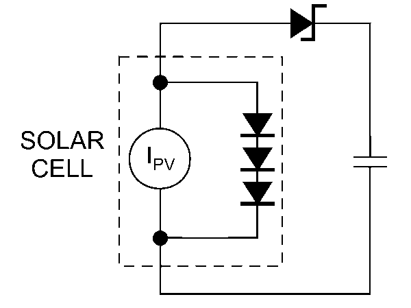

 Figure 2. This simple and effective charging circuit targets use in cases in which the open-circuit voltage of a solarcell array is less than the supercapacitor’s rated voltage.
In contrast to a battery, a supercapacitor need not charge at a constant voltage but charges most efficiently by drawing the maximum current the source can supply. Figure 2 shows a simple and effective charging circuit for cases in which the open-circuit voltage of a solar-cell array is less than the supercapacitor’s rated voltage. The diode prevents the supercapacitor from discharging back through the solar cell if it goes dark. If the energy source’s open-circuit voltage is greater than the supercapacitor’s voltage, then the supercapacitor requires overvoltage protection using a shunt regulator (Figure 3). A shunt regulator is an inexpensive and simple approach to overvoltage protection, and, once the supercapacitor fully charges, it does not matter whether the excess energy dissipates.

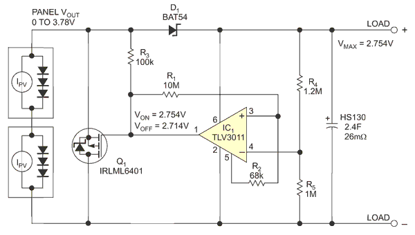

 Figure 3. If the energy source’s open-circuit voltage is greater than the supercapacitor’s voltage, then the supercapacitor requires overvoltage protection using a shunt regulator.
In the circuit in Figure 2, the supercapacitor, at 0V, draws short-circuit current from a solar cell. As the supercapacitor charges, the current decreases, depending on the solar cell’s voltage/current characteristic. The supercapacitor always draws the maximum current it can, however, so it charges at the highest possible rate. The circuit in Figure 3 uses the TLV3011 comparator because it integrates a voltage reference, draws only approximately 3-μA quiescent current, and is an open-drain cell so that the output is open-circuit when the regulator is off. This circuit uses the BAT54 diode because it has a low forward voltage at low currents – that is, the forward voltage is less than 0.1V at a forward current of less than 10 μA.

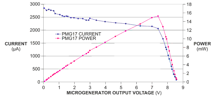

 Figure 4. The voltage-current characteristic of a microgenerator is similar to that of a solar cell and delivers maximum current into a short circuit.

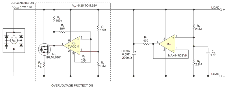

Microgenerators are ideal for industrial-control applications, such as monitoring rotating machinery, because by definition they will vibrate when they are operating. Figure 4 shows the voltage-current characteristic of a microgenerator, which is similar to that of a solar cell and which delivers maximum current into a short circuit. A microgenerator also includes a diode bridge, which prevents the supercapacitor from discharging back into the generator, leading to a simple charging circuit (Figure 5).
 Figure 5. A microgenerator includes a diode bridge, which prevents the supercapacitor from discharging back into the generator, leading to a simple charging circuit.
The open-circuit voltage is 8.5V, requiring a dual-cell supercapacitor, such as the CAP-XX HZ202, which operates at 5.5V. A shunt regulator provides overvoltage protection, and a lowcurrent active-balance circuit ensures even distribution between the cells. Linear Technology, with its LT3652l, LTC3108, and LTC3625 ICs, and Texas Instruments, with its BQ25504, charge supercapacitors from energy-harvesting sources.

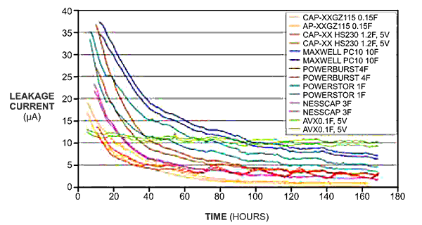

Leakage current
Because some energy harvesters deliver only a few microamps, leakage current becomes important. Supercapacitors can have leakage currents of less than 1 μA, making them suitable for energy-harvesting applications (Figure 6).
 Coupling a supercapacitor with a small energy-harvesting source
 Figure 6. A rule of thumb for equilibrium-leakage-current CAP-XX supercapacitors at room temperature is 1 μA/F.
When a supercapacitor charges, the leakage current decays over time as the ions in the carbon electrodes diffuse into the pores. The leakage current settles to an equilibrium value, which depends on capacitance, voltage, and time. Leakage current is proportional to cell capacitance. A rule of thumb for equilibrium-leakage-current supercapacitors at room temperature is 1 μA/F. The 150-mF capacitors in Figure 6 have leakage currents of 0.2 and 0.3 μA after 160 hours. Leakage current increases exponentially with temperature. The time it takes to settle to the equilibrium value decreases with increased temperature as the ions diffuse more rapidly. Thus, these capacitors require a minimum current to charge from 0V. Depending on the supercapacitor, this current ranges from 5 to 50 μA. Designers should consider testing the minimum charging current when selecting a supercapacitor for an energy-harvesting circuit.

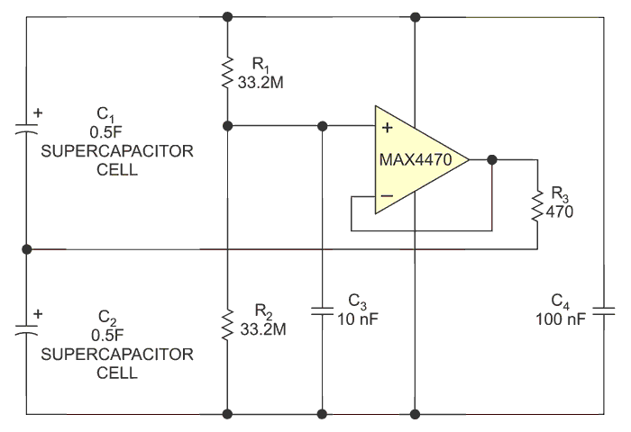

Circuits requiring that the supercapacitor’s terminal voltage is greater than the cell-rated voltage require several supercapacitor cells in series to reach the rated voltage, such as 5V or 12V. In this case, a cell-balancing circuit is necessary; otherwise, one of the cells could go into an overvoltage condition because the cells all have slightly different leakage currents, with different voltage-to-leakage-current characteristics. Because they are in series, however, they must all have the same leakage current. To achieve this goal, the cells redistribute charge among themselves; in doing so, one cell may go into an overvoltage state. Cells at varying temperatures or aging over time at different rates can exacerbate this problem. The simplest balancing circuit is a resistor in parallel across each cell. Depending on the leakage current of the supercapacitor and the operating temperature, the resistor’s value typically ranges from 1 to 50 kΩ, but the leakage current through the balancing circuit is too high for most energy-harvesting applications. A better approach for energy-harvesting applications is to use a low-current active-balance circuit (Figure 7).
 Figure 7. Low-current active-balance circuits target use in energy-harvesting applications.
The MAX4470 op amp in the figure has a supply current of 750 nA and a rail-to-rail input and output. R3 limits the output current in the event that one cell causes a short circuit. The resulting design draws 2 to 3 μA after 160 hours of balancing a 0.5F CAP-XX HW207 supercapacitor.
