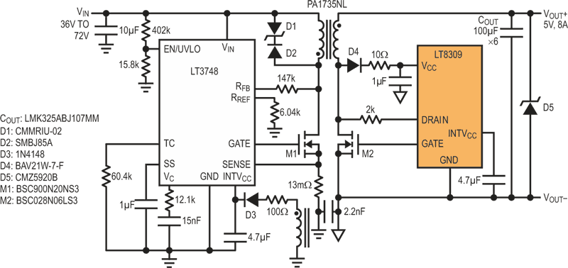

5 V, 8 A Isolated Supply
Figure 1 shows a low voltage, high current, low parts count flyback supply. The traditional output diode is replaced by an ideal diode consisting of the LT8309, a MOSFET and a few small external components.

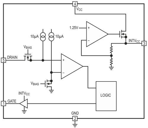

For a MOSFET to act as a diode it must turn on as soon as the body diode starts conducting current, and turn off as soon as its current decreases to zero. The LT8309’s fast comparator produces the required near instantaneous action (Figure 2). The current sensing comparator monitors the drain voltage of the MOSFET. When the body diode begins to conduct, the drain voltage goes well below ground, the comparator trips and turns on the MOSFET. After a minimum on-time, the LT8309 waits for the MOSFET turn-off trip point to be reached to turn off the MOSFET. The turn-off trip point can be adjusted through an external resistor connecting the part’s DRAIN pin to the drain of the MOSFET. The DRAIN pin has a 150 V voltage rating, making it suitable for wide input voltage design as well.
Increase Current Capability and Simplify Thermal Design of Flyback Converters with Secondary-Side Synchronous Rectifier Driver in a 5-Pin SOT-23
Figure 2. The LT8309 block diagram.
LT8309’s internal LDO generates a 7 V output at the INTVCC pin for the MOSFET gate drive. The strong gate drive with 1 Ω pull-down resistance speeds up turn-on and turn-off of the MOSFET, resulting in better efficiency.

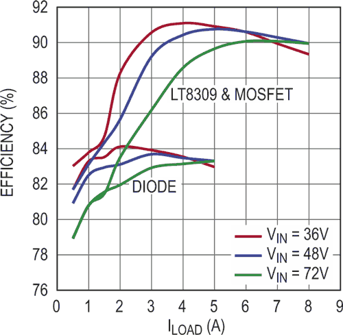

Efficiency is shown in Figure 3 with a comparison to a diode-only design. Thanks to higher efficiency, the operating temperature of a board built around an LT8309-based design remains significantly lower than a diode-only design, as shown in Figures 4 and 5.

The 40 V VCC pin rating allows the LT8309 to be driven from the output voltage or the rectified drain voltage of the MOSFET. If the VCC pin is connected to the output of the flyback converter, during an output short-circuit condition, the LT8309 is off and the body diode of the MOSFET must handle the short-circuit condition. This puts additional thermal requirements on the MOSFET. Instead, if VCC is connected to the drain voltage of the MOSFET as shown in Figure 1, VCC is equal to VIN/N in short-circuit, allowing the LT8309 to operate during a short. The short-circuit current flows through the MOSFET instead of the body diode.
