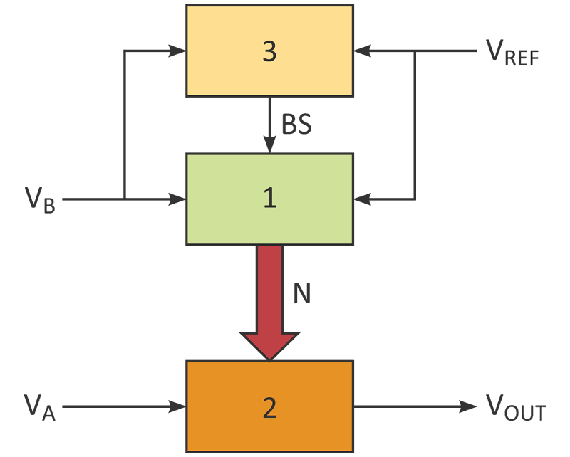

Figure 1. Three functional blocks interact in this improved analog-divider
design. There’s feedback between Block 1 (a compensating ADC)
and Block 2 (the division output), with a "stop" comparison at Block 3.
To achieve much greater precision, the proposed approach uses a modified analog-to-digital converter (ADC) and two digital-to-analog converters (DACs) to do the division, with the precision determined by the number of bits in each DAC. In the circuit structure of the division device (Fig. 1). Block 1 is an ADC with a special compensating circuit, consisting of an op amp with DAC1 as feedback. The ADC converts the voltage of the divisor to digital code N. Block 2 is another DAC (DAC2), which yields the output voltage resulting from the division. Block 3 is a comparator that interrupts the conversion if the divisor voltage drops below the minimum possible value.

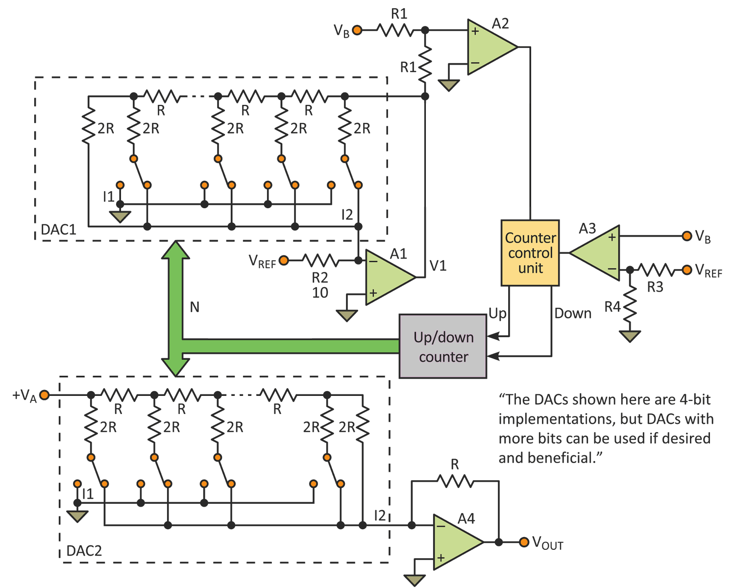

Figure 2. The circuit combines R/2R-style DACs and op amps to function as ADCs,
along with a comparator to control and stop the counter, which terminates
the feedback operation when it decrements to zero. The DACs shown here
are 4-bit implementations, but DACs with more bits can be used,
if desired and beneficial.
In the detailed example of a division circuit (Fig. 2), and using a simplification of realized dependencies, define N as:
where Z and ZMAX are present and maximum sums of least significant bits (LSBs).2 The sums of the LSBs depend on the code resolution.
The proposed ADC differs from the usual ADC implementation in its connection to DAC1, which provides feedback via its position between the input and output of amplifier A1.3 Output I2 of DAC1 connects to the input of A1, and output I1 connects to ground. The connection of amplifier A1 determines the feedback resistance as equal to R when N = 0.
The equivalent resistance (DAC1) to output current I2 is
The input resistor (R2) of amplifier A1 is 10R, when the reference-voltage source VREF is +10 V. The output voltage of amplifier A1 is:
Input voltages VB of ADC and V1 connect to the comparator A2. With VREF = 10 V, the range of voltage VB is +1 V ≤ VB ≤ 10 V. The range of code N is 0 ≤ N ≤ 0.9 for the range VB.
The ADC is balanced when VB – V1 = 0. Then,
or
The output section consists of DAC2 and amplifier A4. DAC2 connects to the input of amplifier A4 by output current I2. Therefore, code N is the information component of VB only.
or
The third part of the device is the comparator A3, which creates a blocking signal BS for controlling the counter. Voltage VB is compared with
If VB becomes less than 1.0 V, then the output signal BS of A3 changes to stop the counter. The output voltage of the division circuit changes polarity depending on the polarity of VA.
The example circuit provided here reduces the error to less than ±0.02%, based on the resolution of both DACs. You can increase precision further by increasing the number of bits, with the resistors connected in series within each DAC.
