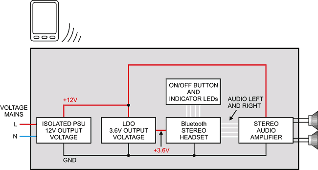

A block diagram of the system is described in Figure 1.
Simple Wireless Bluetooth Stereo Audio System for Outdoor Use
Figure 1. Block diagram of wireless Bluetooth stereo audio system.
This system is based on a stereo Class D audio amplifier which is driving a pair of 4 Ω speakers.

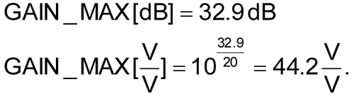

From Figure 6 it is apparent that the MAX98400A amplifier needs few external components for its function. The amplifier's gain is selected with SV1 and SV2; maximum gain is 32.9 dB, which equals 44.2 V/V:
The maximum gain is selected when SV1 is open and SV2 pins 1 and 2 are connected together (Table 1).

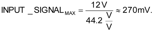

Therefore, with a 12 V supply voltage and 44.2 V/V gain, the maximum input signal that can be used without clipping and distortion to the output signal is:
The amplifier has an integrated clipping-limiter circuit that prevents output clipping distortion. That capability is very convenient, because with maximum gain and without the clipping limiter the headset's output signal would need to be adjusted to 270 mV (max) to ensure that the audio amplifier's output signal is not clipped and distorted when volume is set at maximum level. Alternatively, the MAX98400A's gain can be lowered by choosing different settings for SV1 and SV2.
