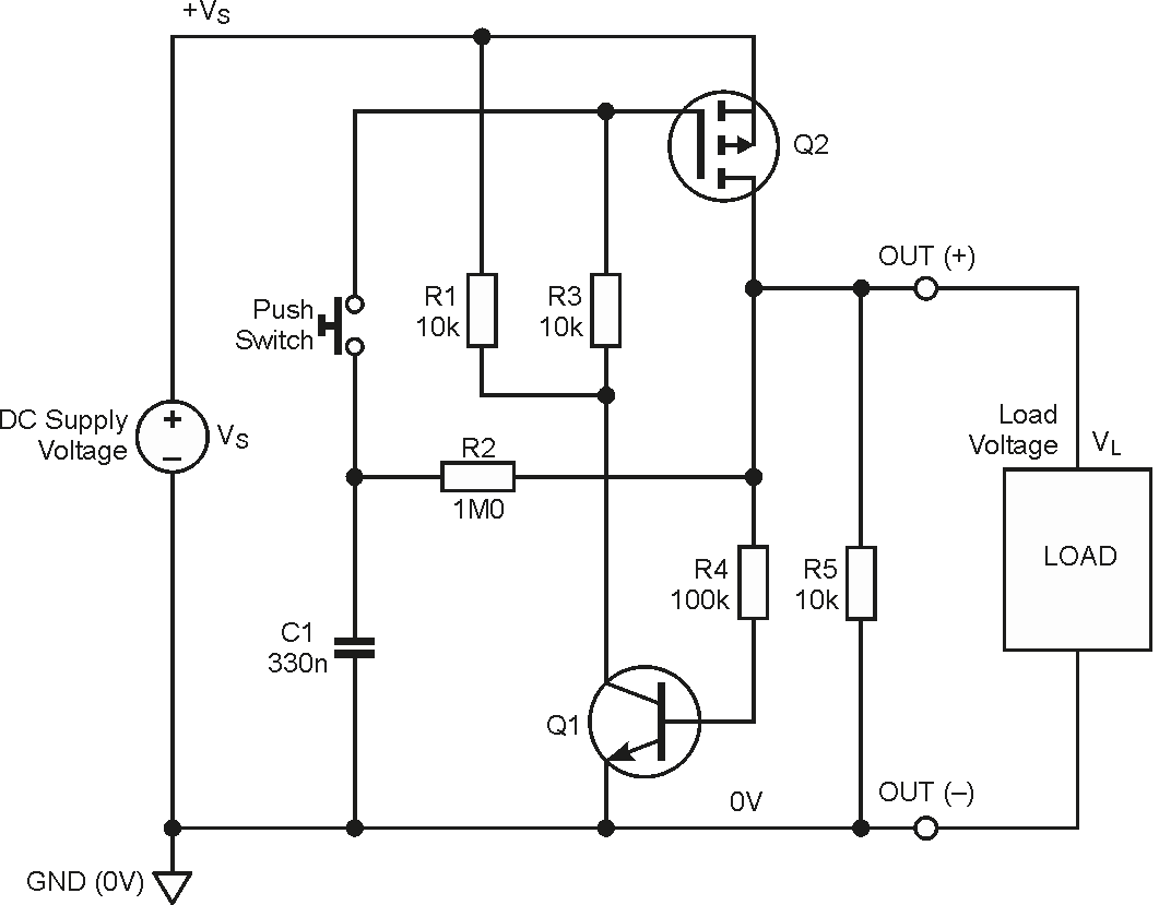

The circuit in Figure 1(a) is configured to latch power to a low-side (ground-referred) load. It works in 'toggle' mode; that is, the first switch closure applies power to the load, the second removes power, and so on.
Latching power switch uses momentary pushbutton Latching power switch uses momentary pushbutton
а) б)
Figure 1. Circuit converts momentary action push switch into latching power switch.
To understand how the circuit operates, assume that the DC power supply, +VS, has just been applied, capacitor C1 is initially uncharged, and Q1 is off. The P-channel MOSFET, Q2, is held in its off state by R1 and R3, which work in series to pull the gate up to +VS, such that VGS is zero. The circuit is now in its 'unlatched' state, where the load voltage, VL, at the OUT (+) terminal is zero.
If the normally-open push switch is momentarily closed, C1 – being uncharged – pulls Q2's gate to 0 V, thus turning on the MOSFET. The load voltage at OUT (+) now rises immediately toward +VS, and Q1 receives base bias via R4 and turns on. Under these conditions, Q1 saturates and pulls Q2's gate low via R3, thus holding the MOSFET on when the switch has opened. The circuit is now in its 'latched' state, where both transistors are on, the load is energized, and C1 charges up to +VS via R2.
When the switch is momentarily closed for a second time, the voltage on C1 (by now approximately equal to +VS) is transferred to Q2's gate. Since Q2's gate-source voltage is now roughly zero, the MOSFET turns off and the load voltage falls to zero. Q1's base-emitter voltage also falls to zero and the transistor turns off. Therefore, when the switch is released, there is nothing to hold Q2 on, and the circuit reverts to its 'unlatched' state, where both transistors are off, the load is de-energized, and C1 discharges via R2.
Resistor R5 across the output terminals is an optional component that acts as a pull-down. When the switch is released, C1 discharges via R2 into the load. If the load impedance is very high (i.e., similar in magnitude to R2), or if it contains active devices such as LEDs, the load voltage at the instant Q2 turns off may be large enough to bias Q1 on via R4, thereby preventing the circuit from turning off properly. The presence of R5 pulls the OUT (+) terminal down to 0 V when Q2 turns off, thus ensuring that Q1 turns off rapidly, and allowing the circuit to revert to its unlatched state in a proper manner.

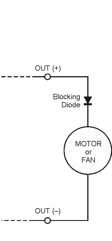

Provided the transistors are correctly rated, the circuit will work over a wide voltage range and is well suited to driving loads such as relays, solenoids, LEDs, and so on. However, beware that certain DC fans and motors continue to rotate when their drive power is removed. This rotation can generate an EMF large enough to bias Q1 on, thereby preventing the circuit from switching off. You can eliminate this problem by inserting a blocking diode in series with the output, as shown in Figure 1(b). You must also include R5 to ensure Q1 turns off properly.

Note that in both circuits, the time constant produced by C1-R2 provides for debouncing of the push switch contacts. Normally, a value of 0.25 s to 0.5 s should be adequate. Smaller time constants may lead to erratic behaviour, whereas a larger time constant increases the waiting time between switch closures necessary to ensure that C1 charges and discharges properly. With C1 = 330 nF and R2 = 1 MΩ as shown, the time constant is nominally 0.33 s. This is usually sufficient to debounce the contacts and to allow the load power to be toggled after a couple of seconds or so.
