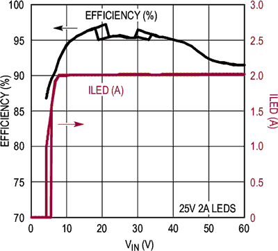

The LT8391 high power buck-boost LED driver in Figure 1 drives 25 V of LEDs at 2 A from a wide input voltage range. Efficiency can reach 98% at its highest point. Over the typical automotive battery range of 9 V to 16 V, the converter operates between 95% and 97% efficiency (Figure 2). With a single high power inductor, the temperature rise is low, even at 50 W. At 12VIN, no component rises more than 25 °C. At 6VIN, the hottest component rises less than 50 °C with a standard 4-layer PCB and no heat sink or air flow. This leaves room to increase the power output of the converter, making hundreds of watts possible.
| Figure 2. | (a)The Efficiency of Figure 1 50 W LED Driver Has a Peak of 98% and Ranges from 95% to 97% Throughout the Typical 9 V to 16 V Automotive Input Range. (b) The LT8391 Peak Inductor Current Limit Can Maintain Stability with Reduced Output Power at Low VIN. |
The LT8391 operates down to 4VIN, where IIN can get very high. The LT8391 is designed to either handle very high input currents or use its peak switch current limit to operate with stability at low VIN while reducing output power. This allows the converter to run through automotive cold-crank voltages or other drops in VIN without an increase in power component size or cost.

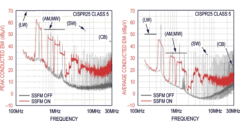

SSFM reduces EMI in switching regulators. Although the switching frequency is most often chosen to be outside the AM band (530 kHz to 1.8 MHz), unmitigated switching harmonics can still violate stringent automotive EMI requirements within the AM band. Adding SSFM significantly reduces EMI both within the AM band as well as other regions.
When activated, SSFM drops the LT8391’s 50 W LED driver EMI below both the peak and average EMI requirements of CISPR25 (Class 5) in the AM band (Figure 3). CISPR25 average EMI limits are 20 dBμV lower in some places than peak limits, and harder to pass for switchers. For this reason, LT8391’s novel SSFM reduces average EMI more than its peak. There is 18 dBμV or more reduction of average EMI and about 5 dBμV of peak EMI reduction.
| Figure 3. | SSFM Reduces LT8391 Peak and Average EMI Below CISPR25 Class 5 Limits. Average EMI Has Even Greater Reduction Than Peak EMI. |

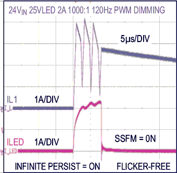

In some LED converters, SSFM and PWM dimming do not work together without causing flicker. SSFM, a source of changing switching frequency, may appear as noise to the outside world in order to spread EMI lower than its non-spread peak values, but it can work with PWM dimming for flicker-free operation (Figure 4). Linear’s patent pending PWM dimming and SSFM operation runs both functions simultaneously with flicker-free operation, even at high dimming ratios. At 1000:1 PWM dimming with external PWM and at 128:1 internally generated PWM, SSFM operates with flicker-free LED current.
| Figure 4. | Infinite-Persist Scope Capture Shows Flicker-Free Dimming with PWM and SSFM Working Together. |
