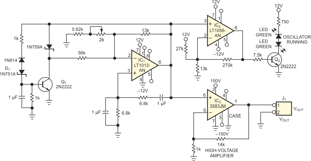

When working for a telephone company, I had to develop a 20-Hz, high-voltage sine-wave ringer circuit. The circuit had to be adjustable from 20 to 200 V p-p. The most difficult part was that I had to adjust the oscillator's gain to a value below unity.
| Figure 1. | This Wien-bridge oscillator is, according to the author, the first oscillator that can function at gains below unity. |
The basic oscillator had to have gain slightly greater than unity to make the positive-feedback network oscillate. It also needed an AGC loop to control the greater-than-unity gain. So, I added a third loop around the oscillator and dubbed it a voltage-controlled, regulated-output feedback circuit. The end result (Figure 1) is a simple push-pull circuit. By adding D1, a zener diode, to another feedback loop, I maintained the amplitude even when I adjusted the gain to a value lower than unity. The 5.2 V zener diode maintains the gain. The result is that when the gain falls below unity, the amplitude tries to decrease but cannot do so, because the zener-diode voltage pulls it back up. IC2, the LT1056AN amplifier serves as a driver for the two LEDs, which alternately turn on and off at the frequency of the oscillator. IC1, an LT1012AN amplifier has very low offset voltage. IC3, a high-voltage TI/Burr-Brown (ti.com) amplifier, produces the final output of 20 to 200 V. The final result – a major breakthrough – is a Wien-bridge sine-wave oscillator that you can adjust below unity gain, and the circuit still maintains its AGC.
