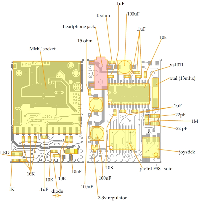

Printed Circuit Board
Parts Layout
Parts Layout
Parts List
quantity
part number
description
1
PIC16LF88, SOIC package (as of april ‘06 mouser has them cheapest)
pic microcontroller
1
VS1011b, SOIC package I think the vs1011e is fine too, but it might need some minor modifications
MP3 decoder chip
1
Alps # SCDA1A0901 (available at Mouser.com)
SD/MMC card socket
1
red low current LED, 1206 package
1
digikey# CP-3523SJCT-ND
stereo headphone jack
1
ECS inc.# ECS-129-18-4 12.96 MHZ or equivalent
12.96 MHz crystal
2-4
digikey# 311-1154-1-ND
22pF capacitor, 1206 package
1
digikey# MCP1700T3302ETTCT-ND
3.3 volt regulator, SOT23-3 package
6
digikey# BC1300CT
0.1uF capacitor, 0805 package
3
digikey# PCE3093CT
100 uF capacitor, surface mount
9
10K resistor, 0805 package
5
digikey# 401-1131-1-ND
mini joystick (4 way plus select)
1
NOT DEFINED
5 pin .1 inch spacing header
1
digikey# SBH-431A-ND
3 cell Ni-MH battery pack (AAA works well)
1
1M resistor 1206 package
1
1K resistor 0805 package
1
digikey# 478-3026-1
10 to 15 uF tantalum cap
