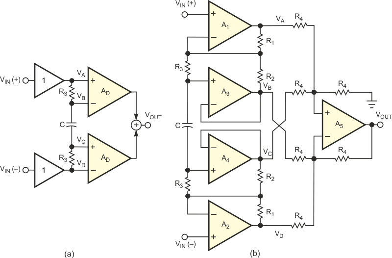

Modern battery-cell voltages of 3 to 3.6 V require circuits that offer efficient low-voltage operation. This Design Idea proposes an ac-coupled instrumentation-amplifier design that features high CMRR (common-mode-rejection ratio), wide dc input-voltage tolerance, and a first-order highpass characteristic. Most of these features stem from a high-gain first-stage design. The circuit uses popular-value and -tolerance components. Figure 1a shows the simplified amplifier circuit. The general principle is that the capacitor, C, and the R3 resistors buffer and ac-couple the input signal. The second stage comprises two differential amplifiers, AD. Each of them amplifies half the differential input signal. A summing operation yields the following expression for VOUT:
In Figure 1a, VA, VB, VC, and VD are the two differential amplifiers' inputs, and AD is the gain. The time constant 2R3C defines the highpass cutoff frequency. Figure 1b shows the detailed circuit. The input stage comprises op amps A1, A2, A3, and A4. A1 and A2 are the main gain stages. Because their inverting and noninverting inputs are at the same potential, the input voltages supply the R3 resistors. The buffers A3 and A4, along with the R2 resistors, produce an amplification factor, 1 + R3/R2, for the current in R3, because R2 and R3 connect to equal potentials. This circuit structure is the heart of the design. The voltage on capacitor C has no ac component, and A1 and A2 each amplifies one-half of the differential-input ac signal. C filters the input dc component, which appears at the A3 and A4 outputs. The second stage is a unity-gain, four-input adder-subtracter stage. It implements the above equation, where
Assuming R3 >> R2,
Capacitor C ac-decouples the simplified amplifier circuit (a); the detailed circuit (b) uses gain stages and an adder-subtracter stage.
Figure 1. Capacitor C ac-decouples the simplified amplifier circuit (a); the detailed circuit (b) uses gain stages
