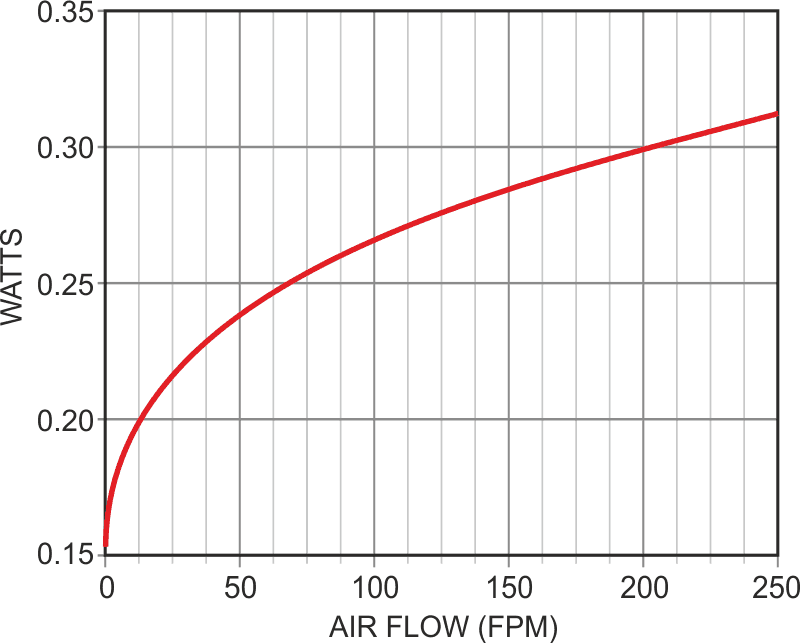

If the transistor junction is held at a constant temperature differential above ambient (e.g., ΔT = 31 °C), the power required to do so will be a function of air speed P = 31/ZT as shown in Figure 1. Note the annoying non-linearity.
Power dissipated versus air flow of TO-92 held at a constant 31 °C above ambient (PW = 31/ZT).
Figure 1. Power dissipated versus air flow of TO-92 held at a constant 31 °C

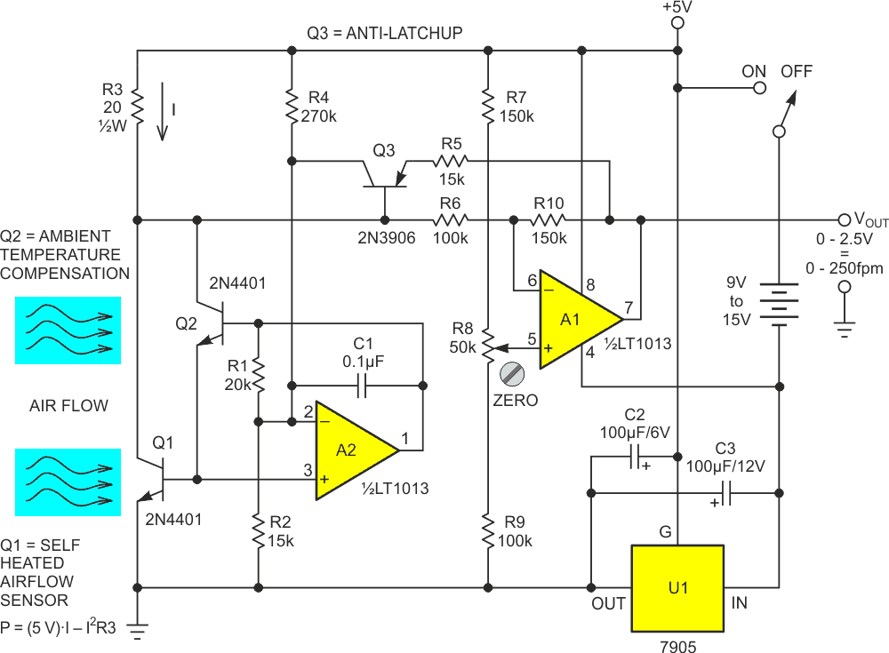

Figure 2 shows a practical portable thermostat circuit to achieve and maintain this ΔT utilizing a Darlington transistor pair (Q1 and Q2) to compensate for ambient temperature and convert the resulting nonlinear PW curve into a linearized anemometer air flow readout.
Linearized portable Darlington anemometer schematic.
Figure 2. Linearized portable Darlington anemometer schematic.
Here’s how it works.
Q1 serves as the self-heated sensor modeled in the Figure 1 math, with Q2 providing ambient temperature compensation. Op-amp A2 runs a feedback loop that forces the Vbe differential between Q1 and Q2 (and thus the temperature differential between Q1 and ambient) to hold a constant 31 °C. It does this (with the help of Darlington current gain) by forcing Q1’s current draw (I) through R3 to drive Q1’s power dissipation (PW) to follow the Figure 1 curve of heat-vs-air flow. The resulting voltage developed (I•R3) is the basis of the air speed measurement.
Okay so far. But how does compensation for Figure 1’s nonlinearity happen?

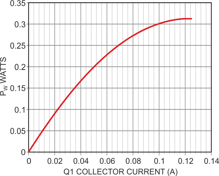

Well, it turns out the function of Q1’s PW vs collector current, I, isn’t linear either. In fact:
That quadratic I2 term is very useful. It’s responsible for the lovely curve shown in Figure 3.
Q1 power versus collector current.
Figure 3. Q1 power versus collector current.

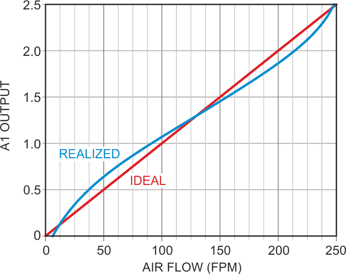

The 2nd-order curvature of Figure 3 is what compensates for the bend in Figure 1. Although the match isn’t perfect, when inverted, offset, and scaled by op-amp A1, the realized output is a calibrated readout (1 V = 100 fpm) of air speed that differs from ideal by less than ±5% from 0 to 250 fpm, as shown in Figure 4.
Darlington anemometer output versus actual airspeed.
Figure 4. Darlington anemometer output versus actual airspeed.

A detail of Figure 2 worthy of mention is Q3, which I include to preclude the possibility of the A2 feedback loop getting “stuck” when a transient or other misadventure might cause R3 voltage drop to exceed 2.5 V. This is a potentially bad thing because the PW vs I curve would go “over-the-top” and invert the I vs PW feedback term from negative to positive, causing A2’s output to latch with the Darlington saturated and stay thus stuck for as long as power is provided.
If saturation approaches, Q3 conducts and forces A2 to limit Darlington drive to a safe level until the transient passes and normal temperature regulation can recover.
Another useful detail is “upside-down” regulator U1 which provides not only necessary stability for the 5 V power rail, but also “splits” input power and provides an unregulated, but still useful, negative rail for the op-amps. This simple but handy trick is described in an earlier Design Idea [1].
