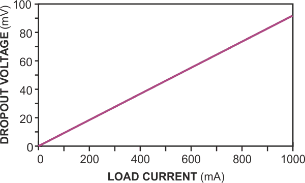

Dropout voltage for the circuit in Figure 1 varies from 10 mV at 100 mA to 90 mV at 1 A.
Figure 2. Dropout voltage for the circuit in Figure 1 varies from 10 mV

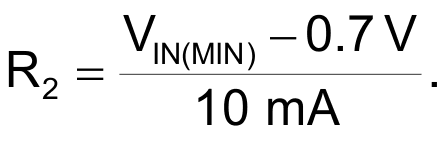

The measured dropout voltage varies with load current (Figure 2). The circuit delivers as much as 1 A at 3.3 V. You can adjust the output from 5.5 V down to 1.25 V using the formula
with appropriate changes to the value of R2, using the formula
