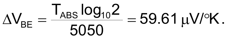

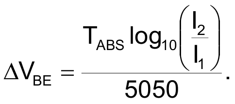

It turns out, wrote Jim, that although the constant-current VBE of a random transistor isn’t usefully predictable, BJT VBE change with variable-current is very predictable. Specifically, it reliably obeys this simple logarithmic equation…
Where TABS = absolute temperature in °Kelvin. Therefore, when used as a thermometer…
Note, that easily remembered “fifty-fifty” constant!
In this thermostat application I2/I1 = 2, so…

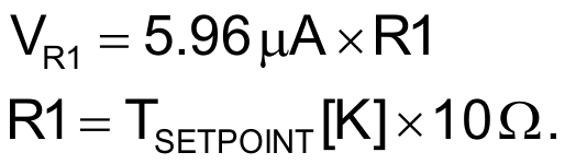

Setpoint Compare occupies the next 520 µs while IQ1 doubles from 50 mA to 100 mA, producing the aforementioned I2/I1 = 2 and thus a 59.61 µV/°K temperature-measurement VBE delta. A1a compares this to the programmed temperature setpoint with setpoint bias resistor R2 scaled so that…
Table 1 shows some example R1 values for selected setpoint temperatures (closest standard resistor values).
