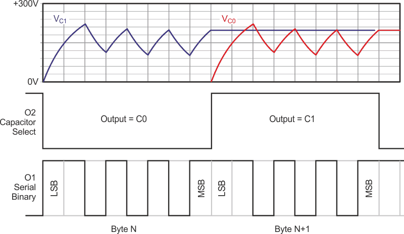

RLY2 directs this to one of two integrating capacitors (C0 or C1) via R1 for a Shannon style time constant of
or
as shown in Figure 2, while the other integrator capacitor holds the previous conversion result for output. As each conversion reaches completion, bit O2 causes RLY2 to change state and alternate the roles of C0 and C1. For the example bit stream shown, the conversion result is

But what about conversion resolution, linearity, and accuracy? Shannon decoding depends on the accuracy of conversion timing relative to T, as shown in Figure 3, showing the effect of 10% RC value error producing a ~2% = 5 LSB conversion error.
This is clearly not compatible with true 8 bit (let alone higher) SD precision.
| Figure 3. | The effect of a 10% T = RC error producing a ~2% = 5 LSB conversion error. |

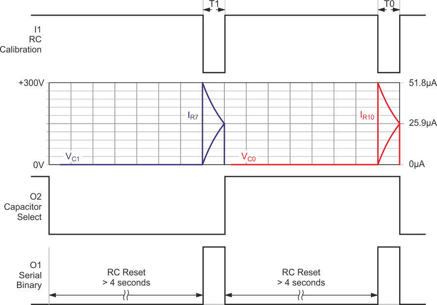

Accommodation of and compensation for inexpensive capacitor tolerances is the purpose of the R7-R10 resistor network, comparator U1b, and the I1 input bit. These are made use of in the time constant autocalibration sequence illustrated in Figure 4.
Autocalibration, which is performed separately for C0 and C1, begins with selection of the capacitor to be calibrated by the suitable setting of O2, followed by complete discharge of the selected capacitor by setting O1 = 0 for at least 4 seconds. O1 is then set to 1.
| Figure 4. | Tx autocalibration sequence to compensate for large tolerances found with inexpensive capacitors. |
The selected capacitor (C1 for O1 = 0, C0 for O1 = 1) then begins to charge, generating a current pulse into the R7-R10 resistor network, which is coupled as a 5 V voltage pulse into pin 6 of U1b, driving I1 = 0. This state persists until the pin 6 pulse decays by ½ to 2.5 V (U1b pin 7 reference provided by the R5-R6 voltage divider), with pulse duration captured by the µC timing software as the appropriate timing constant, T0 or T1, and used in subsequent SD conversions.
