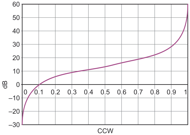

Figure 2 shows the plot of the pseudo-logarithmic result with good log conformity from –10 dB to +40 dB.
Pseudo-logarithmic GIGO gain versus R2 wiper position 0 to 1 = fully CCW to fully CW.
Figure 2. Pseudo-logarithmic GIGO gain versus R2 wiper position 0 to 1 = fully CCW
to fully CW.
