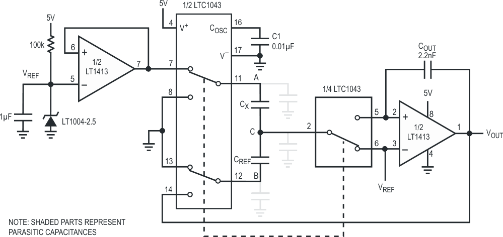

Capacitance sensors measure a wide variety of physical quantities, such as position, acceleration, pressure and fluid level. The capacitance changes are often much smaller than stray capacitances, especially if the sensor is remotely placed. I needed to make measurements with a 50 pF cryogenic fluid level detector, with only 2 pF full-scale change, hooked to several hundred pF of varying cable capacitance. This required a circuit with high stability, sensitivity and noise rejection, but one insensitive to stray capacitance caused by cables and shielding. I also wanted battery operation and analog output for easy interfacing to other instruments. Two traditional circuit types have drawbacks: integrators are sensitive to noise at the comparator and voltage-to-frequency converters typically measure stray as well as sensor capacitance. The capacitance bridge presented here measures small transducer capacitance changes, yet rejects noise and cable capacitance.
A simple, high performance capacitance bridge.
Figure 1. A simple, high performance capacitance bridge.
The bridge, shown in Figure 1, is designed around the LTC1043 switched-capacitor building block. The circuit compares a capacitor, CX, of unknown value, with a reference capacitor, CREF. The LTC1043, programmed with C1 to switch at 500 Hz, applies a square wave of amplitude VREF to node A, and a square wave of amplitude VOUT and opposite phase to node B. When the bridge is balanced, the AC voltage at node C is zero, and
Balance is achieved by integrating the current from node C using an op amp (LT1413) and a third switch on the LTC1043 for synchronous detection. With CREF = 500 pF and VREF = 2.5 V, this circuit has a gain of 5 mV/pF, and when measured with a DMM achieves a resolution of 10 fF for a dynamic range of 100 dB. It also rejects stray capacitance (shown as ghosts in Figure 1) by 100 dB. If this rejection is not important, the switching frequency f can be increased to extend the circuit’s bandwidth, which is
COUT should be larger than CREF.
The circuit operates from a single 5 V supply and consumes 800 µA. If the capacitances at nodes A and C are kept below 500 pF, the LT1078 micropower dual op amp may be used in place of the LT1413, reducing supply current to just 160 µA.
