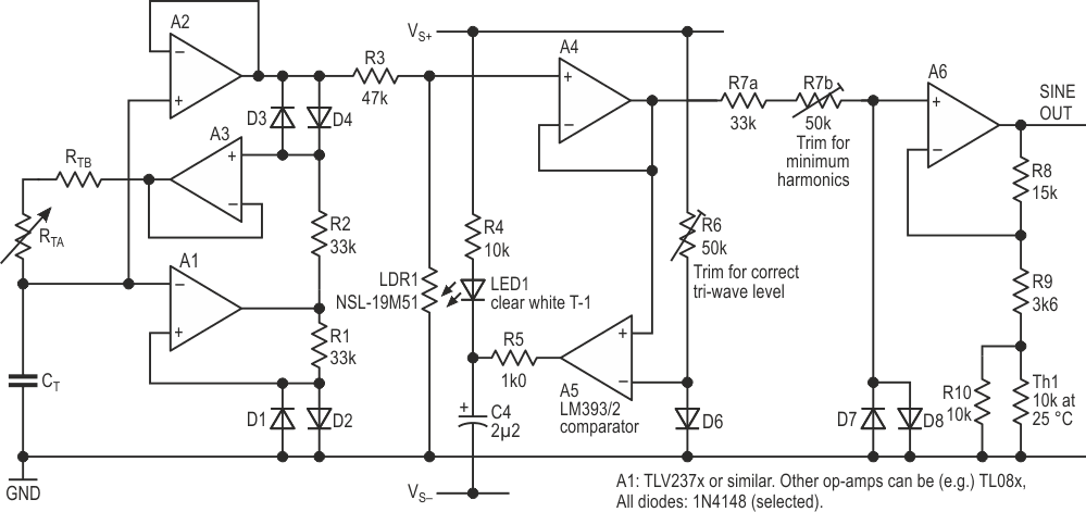

I looked at several types of AGC circuits (strictly, Automatic Level Control). JFETs are the usual starting-point but are inherently non-linear and need to be surrounded by lots of stuff to limit the signal voltage across them and cancel their remaining distortion – several op-amps and a couple of trimmers to do it properly. An LDR avoided the linearity problem, and while this solution may look almost barbarically simple, it works well here. Figure 4 shows the new circuit with the latest modifications.
New tri-wave generator and sine converter test circuit, with AGC.
Figure 4. New tri-wave generator and sine converter test circuit, with AGC.
A5, half of an LM393 dual comparator, senses when the tri-wave’s tip exceeds the reference value and then drives LED1 to illuminate LDR1, whose resistance falls, reducing the signal across R3. The reference is provided by R6 and D6, which track R1 and D2 in the oscillator itself. A4 buffers the output, which is now almost constant below 10 kHz and only 10% up at 25 kHz. (LDR1 was a Silonex NSL-19M51, the LED being a generic T-1 clear white 8 cd device, though an efficient 550 nm green/cyan one would match the LDR’s response better. Thick, black heat-shrink joined and shielded them.) An op-amp with a series pull-down diode replacing R5 also works, but only up to 10 kHz or so owing to its slower response.

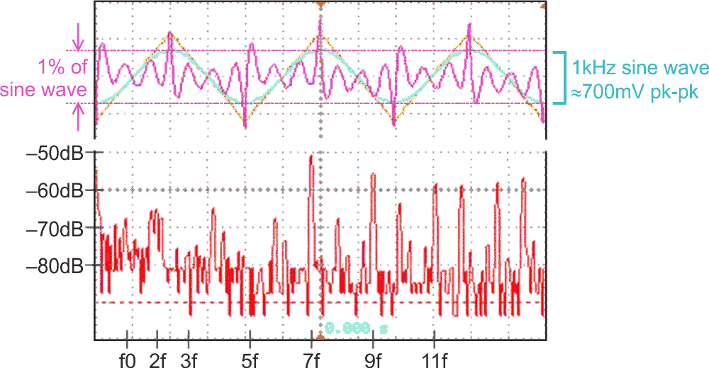

Intuitively, that would seem to be the same as the squashing diodes’ VF, assuming the series resistor to be ideal, and so it proved – with a pleasant and almost shocking surprise in store. With R6 and R7 finely adjusted, the third and fifth harmonics completely disappeared! Figure 5, explained below, shows this.
Results from Figure 4's circuit. The top shows the original triangle and the resulting sine, with harmonics at 100 times their scale; the bottom shows their FFT.
Figure 5. Results from Figure 4’s circuit. The top shows the original triangle and the resulting
But with the slightest mismatch anywhere, one or both harmonics came back. The tri-wave’s level needed to be millivolt-accurate, and A5’s input offset meant that R6 had to be adjustable. The best and most consistent results came when R6 was replaced by a precision current source (not shown) delivering ~275 µA into D6, which eliminated second-order power supply effects. (That’s a higher current than expected because of the offset.) The critical value of R7 was remarkably close to R1/R2 – close to 33k – so perhaps, with perfect components and no AGC necessary, R1, R2, R6, and R7 would all be identical, and with a critical value close to 30k. I leave this one for the theorists!
Removing the fundamental with the notch filter showed that the seventh and higher harmonics were now dominant and couldn’t be tuned out. (Kindly ignore the pesky, residual even ones.) The seventh was at around –50 dB, or 0.3%; after that, the higher, the lower. Figure 5 is a composite of traces: at the top is the original triangle and the resulting sine, with the distortion products – the harmonics – at 100 times their scale; below that, their FFT. This implies that the distortion limit is about 0.4-0.5% in total.
And the output level from the diodes? Intuition (and the waveforms’ geometries) said that the sine’s amplitude should be 1/√2 of the triangle’s, but now it’s wrong: all measurements homed in on 0.666… Presumably the residual harmonics account for the difference, though the numbers look wrong. I expect that a mathematician familiar with the various series defining sines, and how those relate to Fourier analysis, would find the answer obvious.
A6 buffers and amplifies the newly generated sine wave. Note that we have added Th1 – a standard 10k (at 25 °C) thermistor – in the gain-defining network. While the amplitude variation with temperature was unimportant in practical use, it seemed only right to compensate for it. According to LTspice, this network will give the gain we need to raise the sine wave’s amplitude to ~2.2 V pk-pk, or 0 dBu, from 0 to 50 °C. (And that’s the only bit of simulation used here. I hope their diode models are good.) Distortion still varies with temperature. Although D6 and D7/8 are matched in isolation, their drive currents are different, so their functioning VFs neither match nor quite track with temperature. Perhaps mixing another NTC thermistor in with R7 would cure this…
Care needs to be taken to minimize second-harmonic distortion, or waveform asymmetry. Power rails must be well-matched or second-order effects creep in, though apart from the AGC, the circuit is symmetrical and inherently well-balanced. The diodes must be carefully matched in pairs for forward voltage. (Taping a strip of ~50 1N4148s to a sheet of paper, measuring and annotating each one, and then selecting pairs, worked well, for this and other projects.) Surprisingly, dual diodes, or those that I have checked, don’t match internally very well. Offsets within the op-amps cause slight asymmetry. I trimmed most of it out by connecting a 100k pot across the supplies with a 10M resistor from its slider to the junction of R3 and LDR1 (not shown): crude, but effective, if a little sensitive to supply variations.

Calibration of a tuning scale at low frequencies will not be matched on higher ranges because of A1’s performance: the inherent delays affect the tuning law as well as the tri-wave’s amplitude. On my original build, I used a spare section of the range selector switch to vary RTB – the extra end resistance – which helped keep the ends of the scale within 5%.
