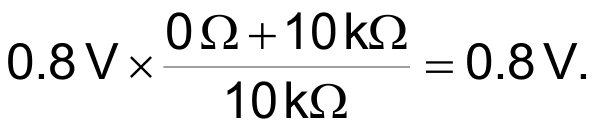

Using the AD5258 with an external resistor provides hardware protection to prevent the output voltage from going above 1.2 V. If the AD5258 is set to zero resistance, the resulting output voltage is

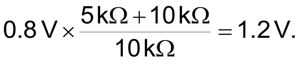

If you set it to its maximum resistance of 5 kΩ, the resulting output voltage is
