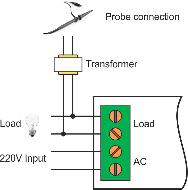

Be careful: never connect your oscilloscope probe directly to the mains. The probe’s ground connection can build a closed loop with the mains terminal and blow up everything in the path, including your circuit, probe or oscilloscope or even yourself!
There are several solutions to overcome this, such as using an isolator or using a differential probe … etc. I used an ordinary transformer (220 V to 12 V) and verified the output just by using this. Please check the Figure 6 for the connections. I have to note that the load must be connected, otherwise you won’t see the true waveform.
Probing the load and required connections.
Figure 6. Probing the load and required connections.
The Figure 7 shows the output waveform (50%). You can expand the code and add two buttons to increase and decrease the output power. You can develop the code and modify it with your own Arduino board and your specific needs.
