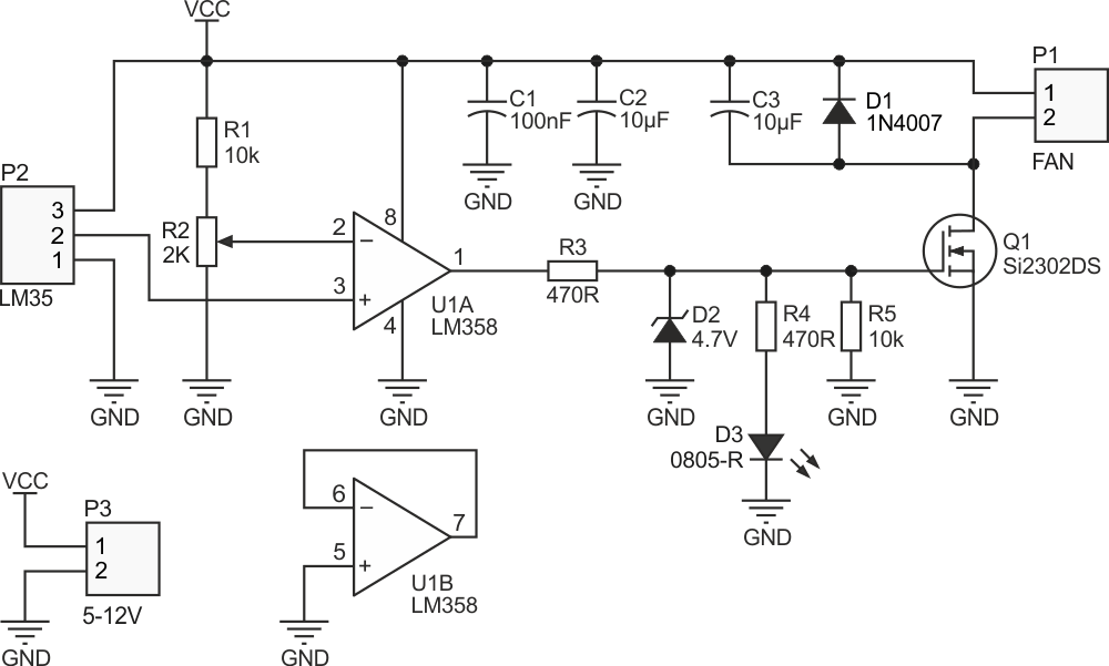

Figure 1 shows the schematic diagram of the device. The two major components are a temperature sensor and an opamp.
| Figure 1. | The schematic diagram of the cooling Fan controller (Altium Designer). |
U1 is the LM358 opamp that is configured as a comparator. If the voltage of the positive input is higher/lower than the negative input, then the output would be close to the VCC/GND. When the temperature of the environment (the voltage on the positive pin) is higher than the pre-set temperature (the voltage on the negative pin), then the output will be activated and vice versa. The LM358 has two opamps. The second opamp is not used and configured as a voltage follower. R2 is a multiturn potentiometer to easily adjust the temperature threshold.
R3 and D2 are used to limit the output voltage of the U1 because the maximum tolerable voltage of the gate pin of Q1 is 8 V, moreover, they help to maintain the voltage of the D3 LED at around 4.7 V, so the value of the R4 is fixed to 470R for any supply voltage. R5 is used to prevent the unwanted triggering of the Q1 gate.
Q1 is the SI2302 N-channel SMD MOSFET that can switch up to 2.2 A continuously, so I decided to use this MOSFET, instead of using a mechanical relay. D1 protects the Q1 against reverse inductive currents and C3 is used to reduce the switching noises. C1 and C2 are bypass capacitors and are used to reduce noises.
