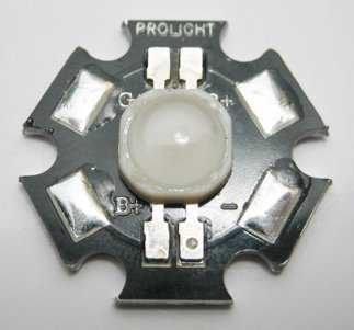

High Power LED
The led used is a high power 3W RGB LED. It can be found on ebay at LEDSEE-electronics. You can also check ebay for other high power RGB leds. It will do the jod the same way. Details of this brilliant led shown below.

Light Angle of the LED
140 degree
Nominal current B,G,R
350mA
Forward voltage
Red
Typ 2,2V
Green
Typ 3,55V
Blue
Typ 3,55V
Wavelength of the LEDs
Red
Typ 625nm
Green
Typ 530nm
Blue
Typ 470nm
Luminous Intensity
Red
Typ 32lm
Green
Typ 35lm
Blue
Typ 10lm
LED type: Common Anode
Note: Minus on the bottom right pin
is common anode (positive voltage)

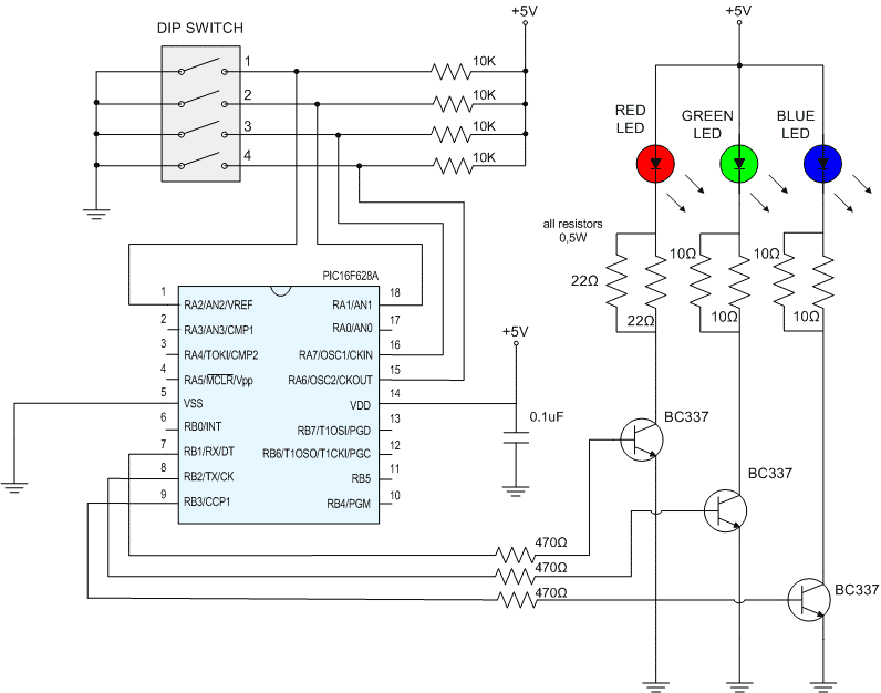

Schematic
The schematic used is shown in the next image. It's as simple as it shows. Take care on the correct transistor mount and correct polarity of power source.

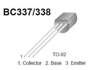

BC337 Pin out
BC337 Pin out

  • 3 x NPN transistors capable of driving 500 mA, for example the BC337
  • one PIC 16F628(A) and a programmer
  • a small perforated circuit board
  • 7 x 10K resistors (1/4W)
  • 1/2 watt resistors (2x 22 Ohm, 4x 10 Ohm) and a DIP switch
  • a power supply (5 volts, 500 mA)
  • Ikea Mylonit lamp or other housing
  • silicon paste from your local DIY shop (if you want to use a heatsink)
  • one z-power 3 watt rgb led
  • a little heatsink and some cooling paste (if you want to use a heatsink)

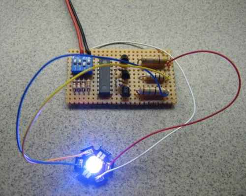

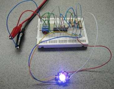

Circuit board
On the next image you can see the circuit arranged on a perforated board.
High Power LED mood Lamp

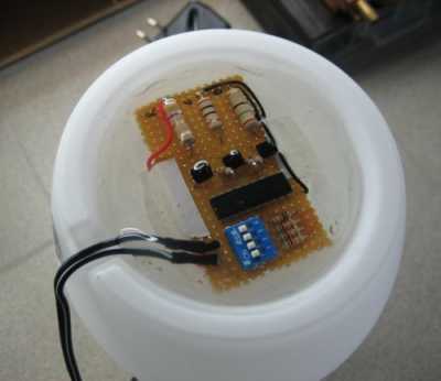

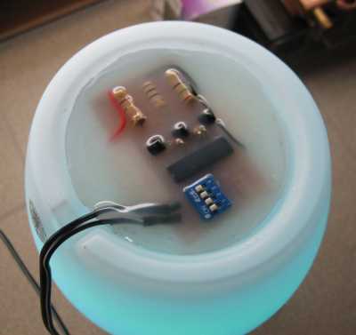

A good way to mount the circuit board is to use a hot glue gun to "mold" the circuit underneath the lamp housing. There is plenty of space there for your board. At the next photos you can see the circuit board mounted on the small 31cm IKEA Mylonit Lamp.
The glue is still hot. Temperature of glue didn't damage the PIC or other parts.
The glue is now cold and you can easily access the dip switches. Lamp is working!

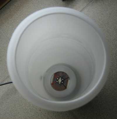

A view from top of the lamp.
