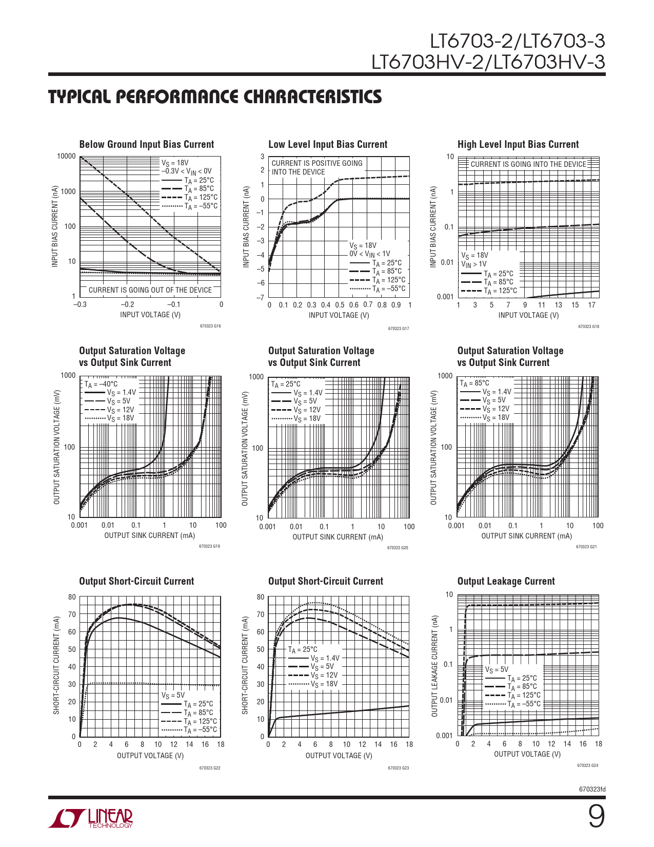

TYPICAL PERFORMANCE CHARACTERISTICS. Below Ground Input Bias Current. Low Level Input Bias Current
TYPICAL PERFORMANCE CHARACTERISTICS Below Ground Input Bias Current Low Level Input Bias Current
LT6703-2/LT6703-3 LT6703HV-2/LT6703HV-3
TYPICAL PERFORMANCE CHARACTERISTICS Below Ground Input Bias Current Low Level Input Bias Current High Level Input Bias Current
10000 3 10 VS = 18V CURRENT IS POSITIVE GOING CURRENT IS GOING INTO THE DEVICE –0.3V < VIN < 0V 2 INTO THE DEVICE TA = 25°C 1 1000 TA = 85°C 1 TA = 125°C 0 TA = –55°C –1 100 –2 0.1 –3 VS = 18V –4 0V < VIN < 1V VS = 18V 10 INPUT BIAS CURRENT (nA) INPUT BIAS CURRENT (nA) TA = 25°C 0.01 V –5 INPUT BIAS CURRENT (nA) IN > 1V TA = 85°C TA = 25°C –6 TA = 125°C TA = 85°C CURRENT IS GOING OUT OF THE DEVICE TA = –55°C TA = 125°C 1 –7 0.001 –0.3 –0.2 –0.1 0 0 0.1 0.2 0.3 0.4 0.5 0.6 0.7 0.8 0.9 1 1 3 5 7 9 11 13 15 17 INPUT VOLTAGE (V) INPUT VOLTAGE (V) INPUT VOLTAGE (V) 670323 G16 670323 G17 670323 G18
Output Saturation Voltage Output Saturation Voltage Output Saturation Voltage vs Output Sink Current vs Output Sink Current vs Output Sink Current
1000 1000 1000 TA = –40°C TA = 25°C TA = 85°C VS = 1.4V VS = 1.4V VS = 1.4V VS = 5V VS = 5V VS = 5V VS = 12V VS = 12V VS = 12V VS = 18V VS = 18V VS = 18V 100 100 100 OUTPUT SATURATION VOLTAGE (mV) OUTPUT SATURATION VOLTAGE (mV) OUTPUT SATURATION VOLTAGE (mV) 10 10 10 0.001 0.01 0.1 1 10 100 0.001 0.01 0.1 1 10 100 0.001 0.01 0.1 1 10 100 OUTPUT SINK CURRENT (mA) OUTPUT SINK CURRENT (mA) OUTPUT SINK CURRENT (mA) 670323 G19 670323 G20 670323 G21
Output Short-Circuit Current Output Short-Circuit Current Output Leakage Current
80 80 10 70 70 60 60 1 50 50 TA = 25°C VS = 1.4V 40 40 V 0.1 S = 5V VS = 5V VS = 12V TA = 25°C 30 30 VS = 18V TA = 85°C VS = 5V TA = 125°C 20 0.01 T 20 A = 25°C TA = –55°C SHORT-CIRCUIT CURRENT (mA) TA = 85°C SHORT-CIRCUIT CURRENT (mA) OUTPUT LEAKAGE CURRENT (nA) 10 T 10 A = 125°C TA = –55°C 0 0 0.001 0 2 4 6 8 10 12 14 16 18 0 2 4 6 8 10 12 14 16 18 0 2 4 6 8 10 12 14 16 18 OUTPUT VOLTAGE (V) OUTPUT VOLTAGE (V) OUTPUT VOLTAGE (V) 670323 G24 670323 G22 670323 G23 670323fd 9
